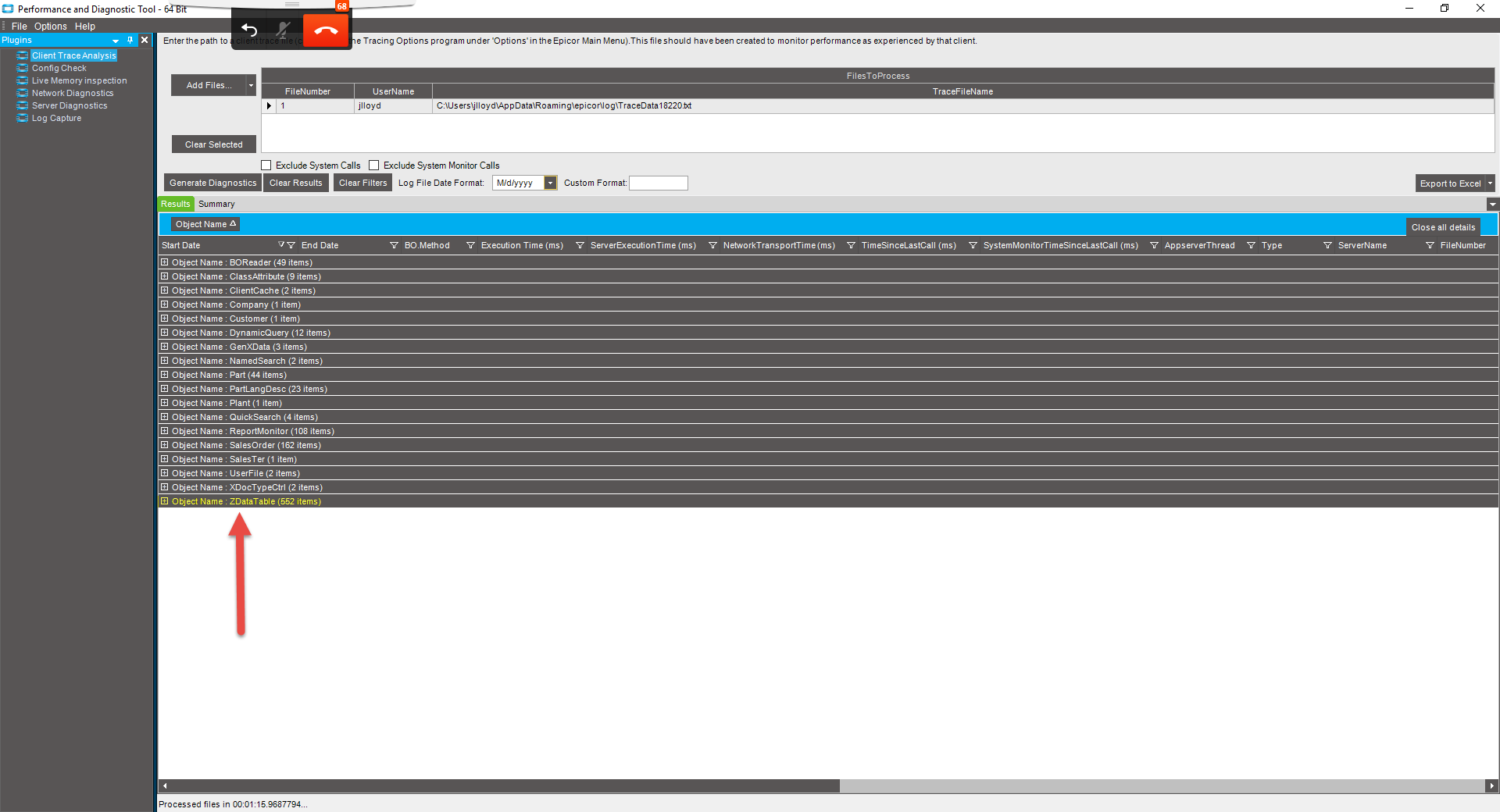

The anomaly that we have found in both local client trace logs and server trace logs is that the ZDataTable object is called the most on any log. In our Test Environment, we do not see this object call. To test the variance, we created a Sales Order with 21 line items paste inserted into Test and Prod. In Test, the trace file is 90mb for this transaction and takes about 1 minute to enter the 21 line items. In Prod, the trace file is 630mb for this transaction and takes about 3 minutes to enter the 21 lines. Below is a screenshot from the PDT with the results of the Client Trace Log.

The underlying issue of the zdatatable calls is addressed in 10.1.500.21+ and all 10.1.600 releases. I’ll call you this afternoon to apply the workaround to verify it is that issue.

Does this workaround also apply to the Epicor Social behavior that also has the innumerable zDatatable call behavior.
It absolutely does. Patch .21 is supposed to fix it if you use Epicor Social. We depreciated Social back in 10.0 but had the fields in Company Maintenance for the ESE Server and Notification ID set. Once those were removed the fields (updated ice.syscompany) and app pools recycle, from there we were off to the races. I had users call me asking what we did to make it run so fast.
