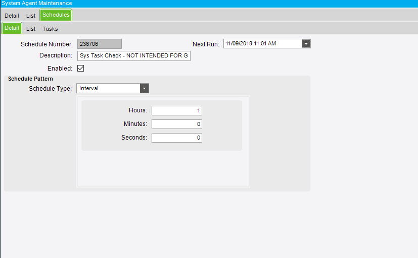

What we did to solve the issue was create a report that queries the Ice.SysTask table and returns rows that have a SysTask.TaskStatus = Error in the past 61 minutes. We inner joined the Ice.SysTask table to Ice.SysAgentSched so that the report only had rows where the task was linked to a schedule. We then scheduled the report on a schedule that repeats every 60 minutes. We excluded this schedule number from the Ice.SysAgentSched table so that this report wouldn’t fire off itself when it had No Rows. Please see the screenshots of the BAQ created, the System Agent Schedule, the Report RDL, and the pdf that we occasionally get when it fails.
