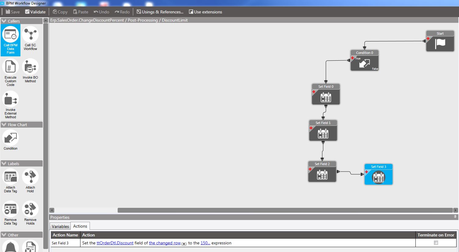

I was hoping you would say that. SO I have a Psot MEthod Directive on Erp.SalesOrder. Here is a pic of it.
Where do I add in the GetByID() at?

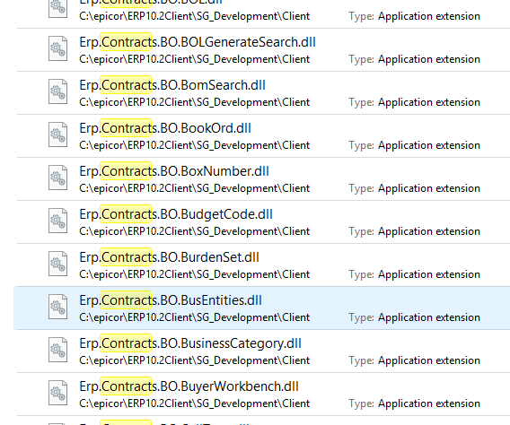

@josecgomez Thank you for the info! I played around with it and figured out where to put it. I’ve only done 1 BPM in the past 1.5 years and only 1 customization that had code. So, not very much experience. My last question is, I see where you are using Erp.Contracts.etc for the the example you told me to view. Where can I find that info for other fields like Update or Job entry screen BPM? Hope this makes sense. I am trying to figure out where to find the info and what each named piece you have represents so I can replicate as I need too.
The Erp.Contracts.XXX is in the DLL for each of the business Objects
And the format is always Erp.Contracts.SvcContract
or if its an Ice framework Contract it would be
Ice.ContractsSvcContract
