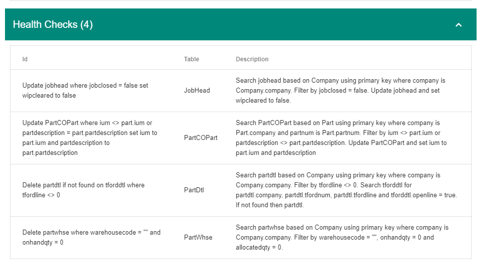

SSR determines the Qty you had on hand on the specified date. It does this by taking the current QOH (from the PartBin records), and subtracts out all the transactions between now, and the specified date.
Do you have access to the Epicor Upgrades Portal (https://upgradeservices.epicor.com/) ?? There is a “ERP Analyzer” tool you can download and run on the App server. It will then do a bunch of checks on the DB, looking for any inconsistencies.
It’ll generate a report (which you have to view online), with a section called “Health Checks”, that will list some things that aren’t as expected, like:
