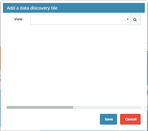

We just went live with 10.2.100 and I had IT publish the Supply Chain Active Homepage. I can log into the Appserver for EDD and look at all 59 tiles. When I try to build my own active homepage using the out of the box tiles, I get the attached when I browse at ‘Add a data discovery tile.’ Page 1 is the initial page and After Scroll is when I scroll to the right. I am unable to further scroll down or select anything. Does anyone know a cause and correction for this? Thanks.

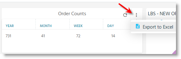

We have this up and running and end users are a bit disappointed that they cannot download from the excel format. I have been unable to find a way to do this.

A BAQ Grid can be exported to Excel by clicking the three dots in the top right of the tile.
Epicor v10.2.300.9.
That is fantastic!! Thank you very much!
Okay, unfortunately, I was not involved with the setup or configuration and do not have access. I do not see the excel option.
Is this a feature in a later version? I’m on 10.2.100.7
Or is there a flag in setup and configuration that I can point them to?
Yeah, EDD in .100 was really early. Most users didn’t adopt EDD and active homepage in that version. It’s come a long way since .300 and they’ve made a lot of improvements. You are probably better off making a traditional dashboard.
