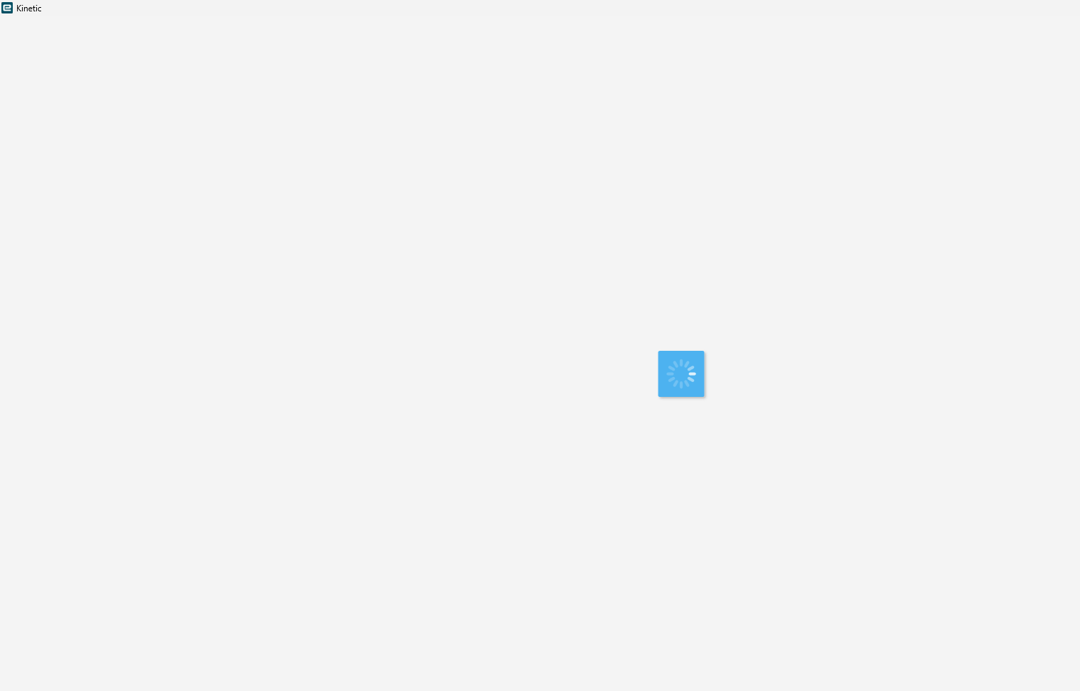

does anyone has this? It works only first time and to run it again I need to reinstall
I had that yesterday but clearing the cache solved it.
this is now fixed for us - Sophos was causing the issues - the antivirus exclusions were quietly updated!
