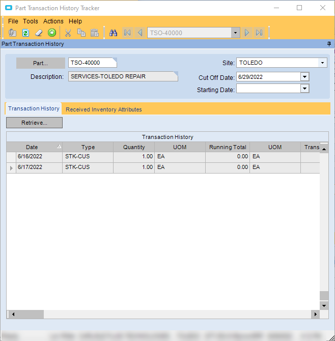

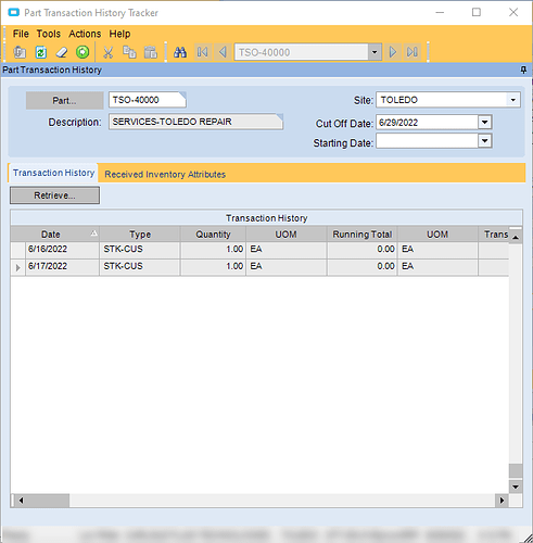

First, I am making an assumption (with 99% probability…), so let’s clarify - if you look at Part Transaction History Tracker for part TSO-40000, is there a STK-CUS transaction for order 447292?
Yes
OK, so, you’ll want to see what GL accounts this is hitting. Do you (or do they) know how to run the Inventory/WIP Reconciliation Report (IWR) for a specific day?
Then separately, you’ll want to run the IWR for the job you made (only that job, and make sure to use a wide date range). And pow-wow with someone there who knows what accounts should be getting cleared, etc.

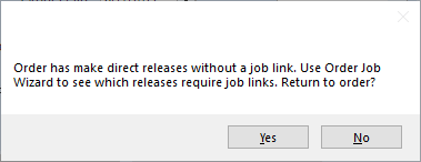

I have a new problem. When I go to ‘leave’ 447292. I get this error.

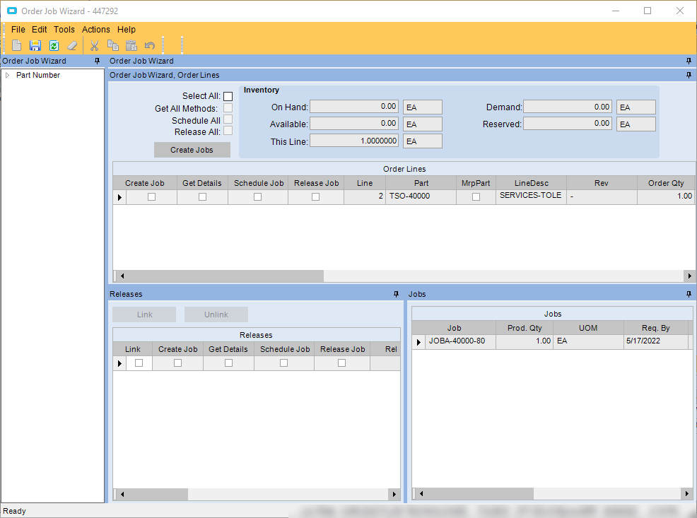

So, I go into the Order Job Wizard (no experience at all) and I don’t know what to do.
Short answer is you can ignore it. It just means “there is work to do.”
I think it’s silly. Like, if you just made the order 3 seconds ago, then, no you haven’t made the job yet - get off my back, Epicor.
Ok, so I’ll just answer ‘no’ and move on.
