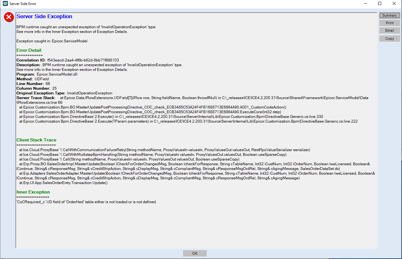

I followed the instructions, but I am getting the error below.
Can you please help?
The casing of the fields has to match. I think I noticed your fields had a lower c in one and an upper in another table.
@gpayne Thank you so much, it works now.

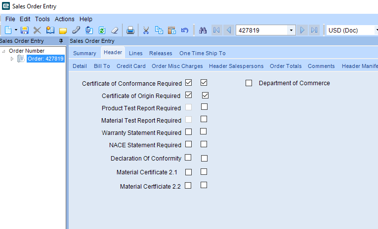

Hi @gpayne
I ran into an issue with this. Can you please help?
The boxes are getting checked but it is not getting saved

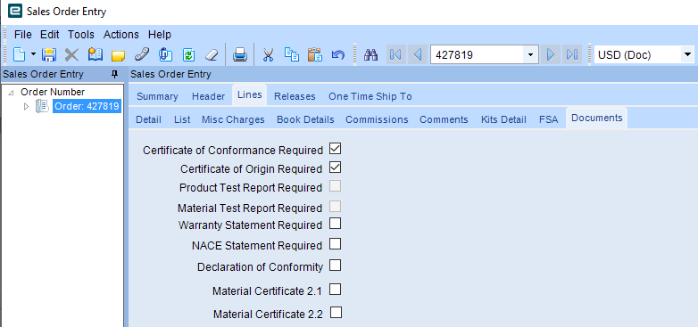

As you can see on the line level:
try adding an update before the holder attach. I can’t test since I have a lot of other bpms on sales order so I don’t know if that will work, but it compiles.
salesBO.Update(ref salesOrder);
I have added the code but it only saves after I check any box on the line level.
Any insights on this?
Thanks.
