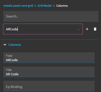

Step 3: Add the field to the grid columns.
Use the field name you gave it in your code - ARCode in this case.
That’s it.

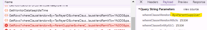

We just implemented this on one of our screens, and it’s great, BUT… we’re having an issue when trying to SORT the grid on the new field that we added. Have you run into any related errors?
We added a custom field, ParentSupplier, onto the grid. The data comes in, but when sorting, we get an error message – Invalid Column Name ‘ParentSupplier’, and it seems like it’s because it’s going back to query the DB with this where clause.
I had not run into that scenario! and it’s good to bring it into the light.
The first thing that comes to mind is to intercept the GetRows call with a pre-processing BPM to change the whereClauseVendor value to something valid - if there’s some value to actually sort by that’s similar to your added field
Or maybe
Intercept in a pre-processing BPM
if (whereClauseVendor == "By+ParentSupplier")
then set some BPM context value, clear whereClauseVendor, and enable post processing
Then in Post, sort by that value before the dataset is returned
You’ll have to pick up the whereClauseVendor value for when it’s sorting descending, too, and handle that scenario similarly

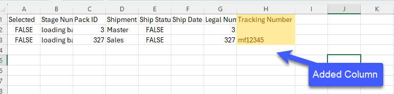

The export to excel function will not include the added column is a limitation I just discovered. I can’t think of a way to make this happen.

Testing in 2025.1.4 and export to excel works for all columns.
