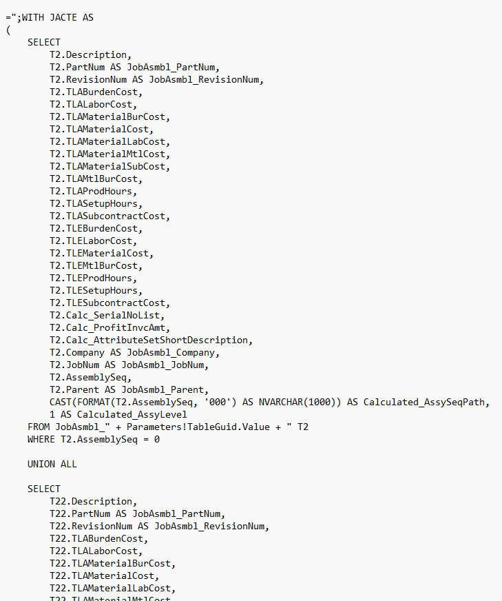

Sorry, meeting and lunch got in the way… had to tweak the JobAsmbl_AssemblySeq to just AssemblySeq because that was the original syntax in the base query which was referenced in various fields and subreports, etc. Once I did that everything seems to be working.
The only thing I’m noticing (so far) in some preliminary testing is getting some repeating rows in the Operations Detail subreport, which I wasn’t getting before. I need to look at the data getting passed to that report and probably pin that down. But otherwise…
If you want to post the query, we can take a look.

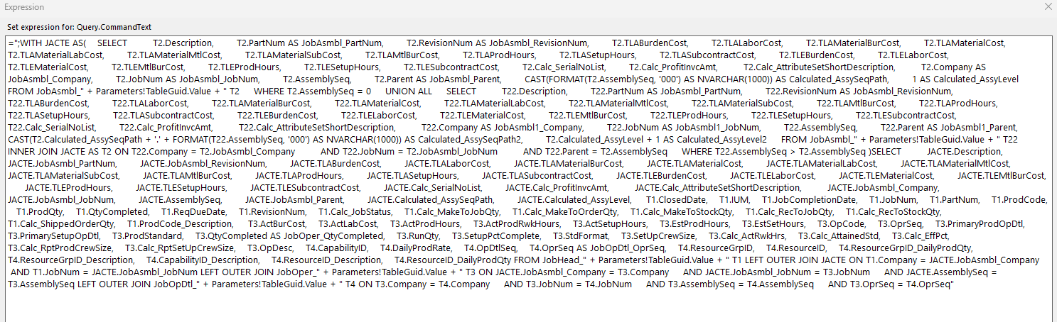

GAH! Had to restart my computer and when I opened my query back up it looks like this:
… and people wonder what @josecgomez is complaining about with Report Builder. THIS is a prime example. ![]()

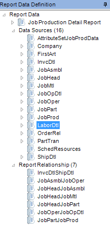

The RDD for ProdDtl includes the LaborDtl table, but it is not included in any of the relationships.
How does this impact the overall query? Is the RDD pulling in the entire LaborDtl table (which seems like it would be HUGE) and then finally filtering it down via the parameters passed from the Main Report to the Sub-Report?

Did you format it? If you did, copy and paste it to notebook and it will still be formatted. The query viewer just does not hold any format when viewing.

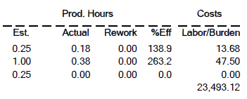

Ugh… the query change also messed with some of the calculations in the report.
This definitely isn’t mathing correctly.

This is where you need to be careful as I have gotten burned more than once before I finally figured it out. Even though there is no relationship, that does not mean that there is not one hardcoded in the background. I finally figured this out when I wanted data from one of those tables and created the relationship myself. When I looked at the table in the report database, there was 2 of every row. This is where having access to the report database really helps ( Access to query SSRS report database in Cloud | Epicor Ideas Portal (aha.io)). The whole table is not loaded, only the records that are needed.
Does not matter. Remember, the RDD is to extract the data out of Epicor and into the SSRS Reports db. Once they are in the database, they are separate tables that you can do anything you want with.
