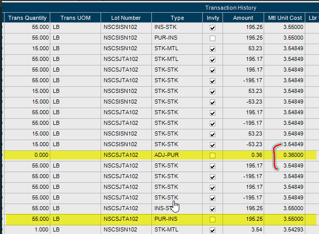

If I run the WIP/Recon, the ADJ-PUR trans only hit the Accrued Receipts, and a Variance account. Nothing to Inventory.
Your PartTran history even shows that there is no change to the cost after an ADJ-PUR tran. See how the Mtl Unit Cost is the same after the ADJ-PUR tran.
