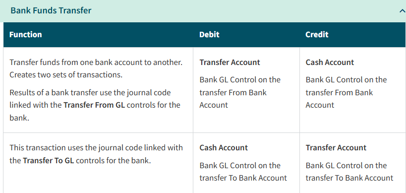

From the GL Transaction hierarchy
From the GL Control Code

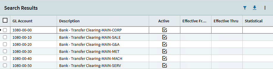

Ah, gotcha. I didn’t do that, but this is what I see in the Demo database. Basically, an asset account from the bank to each other “bank”:
:man_facepalming:
Clearing account. This is what happens when non-accountants try to do an accountant’s job. :laughing:
