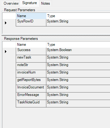

Hi, I am trying to achieve the same regarding invoice PDF over API.
I have used the code below in a Function which when i run using the SysRowID it starts the tasks and generates the correct invoice PDF as expected.

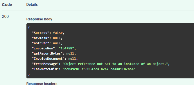

I am retrieving null values for Invoice Document and getReportBytes.
I thought it could have been due to a delay in the PDF creation so i added a 30 seconds sleep thread which didnt solve my problem.
Im confident my Signature > Request & Response parameters are incorrect.

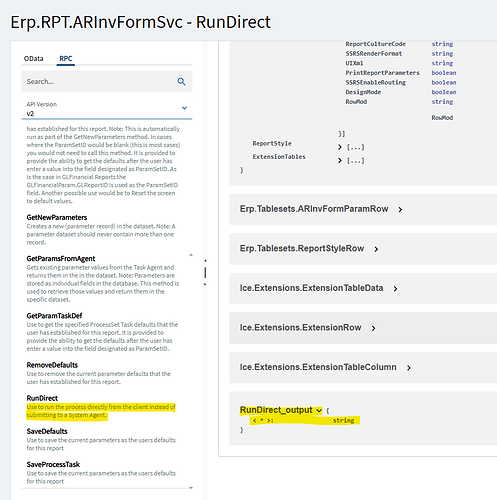

To remove the timing issue, you might want to use the RunDirect method instead of submitting to the Task Agent. The method will return when the “bytes” are ready.
I dont believe timing to be the issue as I can currently see the PDF has completed before the Response is returned.
Is this not using the RunDirect method already?
As per you original posts, do i have the response and requests parameters set up correctly?

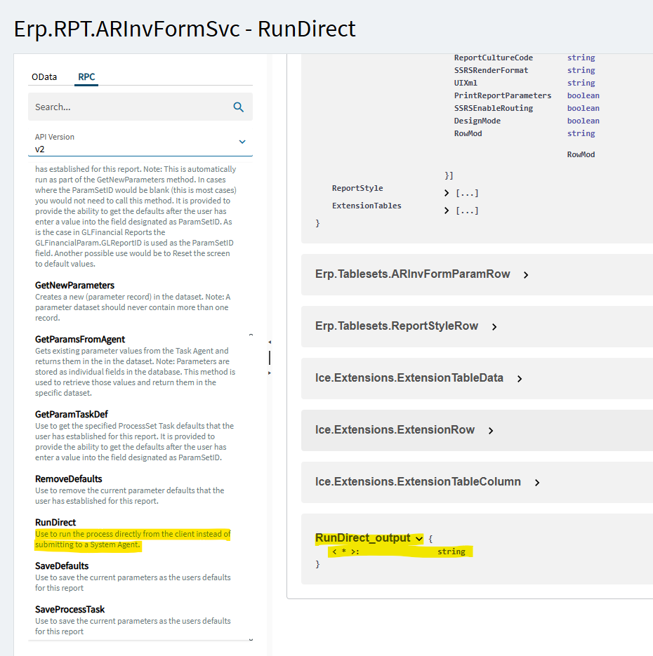

Either RunDirect OR SubmitToAgent need to run for the report to generate. RunDirect returns the bytes directly and SubmitToAgent puts the report in the SysRptLst table.
I don’t see the SubmitToAgent in either example, so that may be an issue.
The task seems to submit ok, as i can download the PDF not problem after running the function via the API.

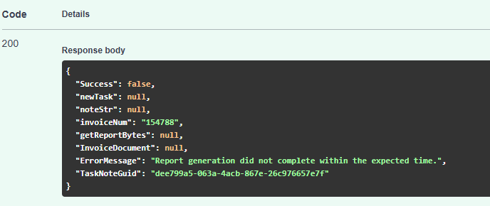

Error is that the Report Generation did not complete but within a seocnd or two i could download the PDF from within Epicor System Monitor.
With RunDirect, that will never be necessary. The function does not return until it either generates, or errors out.
As for the main problem, I took a look at your code and function structure and found some code errors and scope issues.

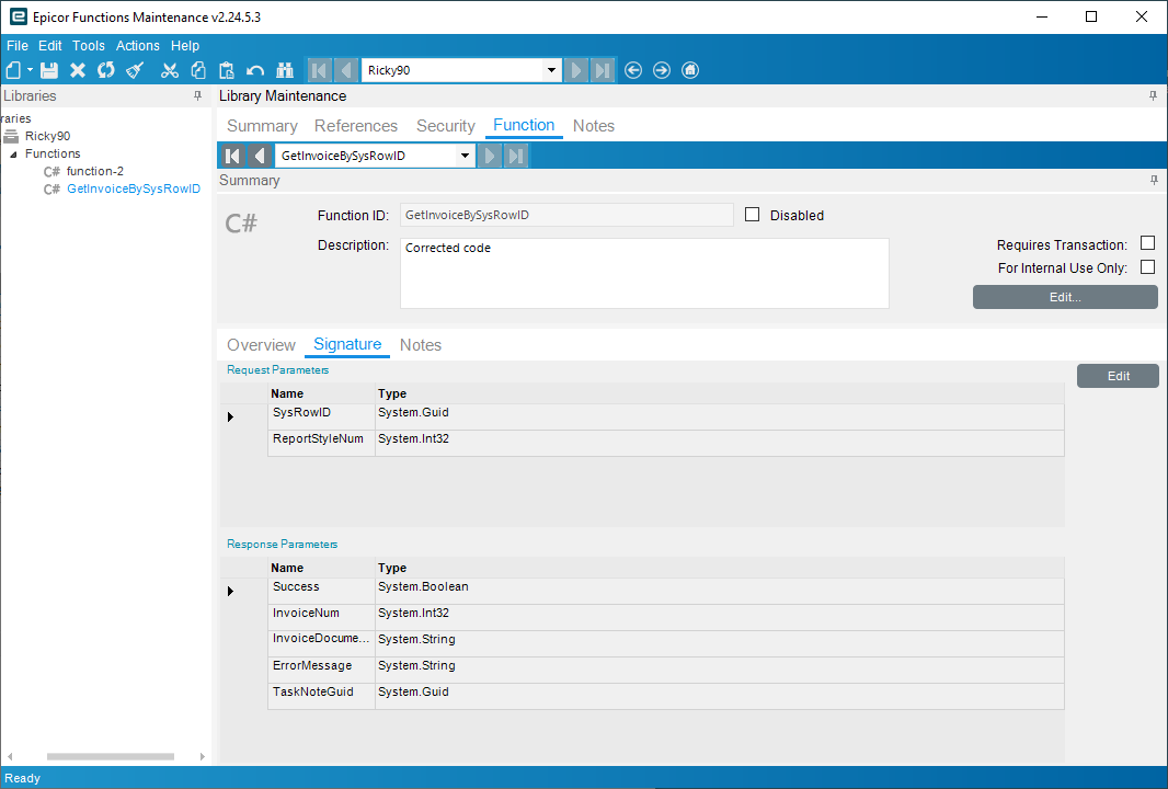

New function, similar to yours, although I would probably look it up by Invoice Number

What went wrong.
this.Success = true;
try
    this.CallService<Erp.Contracts.ARInvFormSvcContract>(arInvFrm => {
        //this was in your function signature as a string, and redefined as a guid.
        //This brings it out of scope and mismatched.
        Guid newTask = Guid.NewGuid();
        //Same here, this is redefined, and now out of scope, this is not the same variable as the signature.
        String noteStr = newTask.ToString();
        var invcRow = Guid.Parse(this.SysRowID.ToString());
        var invoiceNum = (from ih in Db.InvcHead where ih.SysRowID == invcRow select ih.InvoiceNum).FirstOrDefault();
        if (invoiceNum != null && invoiceNum != 0)
            var arInvFrmTs = arInvFrm.GetNewParameters();
            //if (arInvFrmTs != null && arInvFrmTs.ARInvFormParam != null && arInvFrmTs.ARInvFormParam.Count > 0)
                arInvFrmTs.ARInvFormParam[0].AgentID = "SystemTaskAgent";
                arInvFrmTs.ARInvFormParam[0].AutoAction = "SSRSGenerate";
                arInvFrmTs.ARInvFormParam[0].CalledFrom = "Erp.UI.ARInvoiceTracker";
                arInvFrmTs.ARInvFormParam[0].ReportStyleNum = 2; //1001;
                arInvFrmTs.ARInvFormParam[0].SSRSRenderFormat = "PDF";
                arInvFrmTs.ARInvFormParam[0].SSRSEnableRouting = false;
                arInvFrmTs.ARInvFormParam[0].InvoiceNum = invoiceNum;
                //This was missing, this is the magic.
                arInvFrmTs.ARInvFormParam[0].TaskNote = noteStr;
                this.TaskNoteGuid = noteStr;
                this.invoiceNum = invoiceNum.ToString();
                arInvFrm.RunDirect(arInvFrmTs);
                //This is in your function signature, as a string. This not only has been redefined with the var keyword,
                //it is not a string, so that's why it does not show up in the output.
                var getReportBytes = (from b in Db.SysRptLst join st in Db.SysTask on b.SysTaskNum equals st.SysTaskNum
                                      where st.TaskNote == noteStr select new { b.RptDescription, b.RptData }).FirstOrDefault();
                this.InvoiceDocument = Convert.ToBase64String(getReportBytes.RptData);

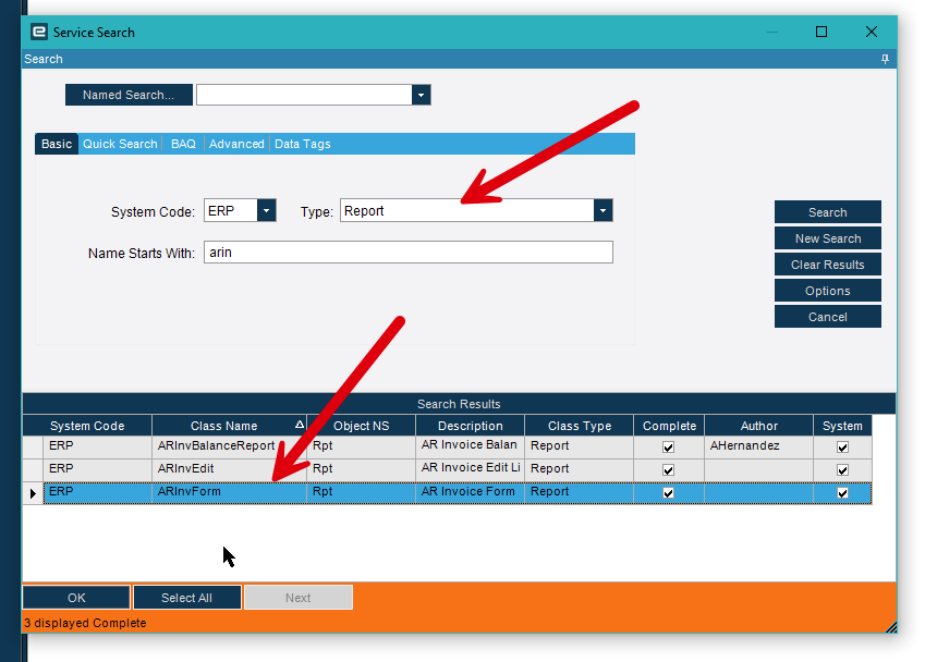

Thanks for posting this! It’s saved me a considerable amount of time. I hit a snag though, I can’t seem to find Erp.Contracts as a service in my version of Kinetic. It’s not in the available list and when I try to check the code I get the missing namespace error.
Contracts isn’t the service. The service is ARInvForm
