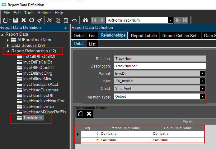

I do not know where to go and check that. I did like how it showing in the screenshot below
This was the relatioship i created in Report data definition.

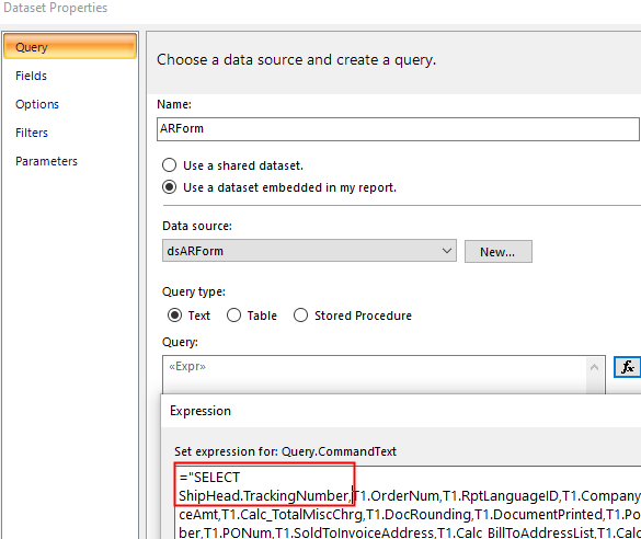

Now you have to add that in the query on your SSRS report. Open up the query and look further down than the screenshot you posted. You will see lines like LEFT OUTER JOIN TABLEX on T1.Company = TAbleX. Company… or something like that. You need to add a join in the query to reflect the join in the data set.
Got it Thanks Utah and Alex!
