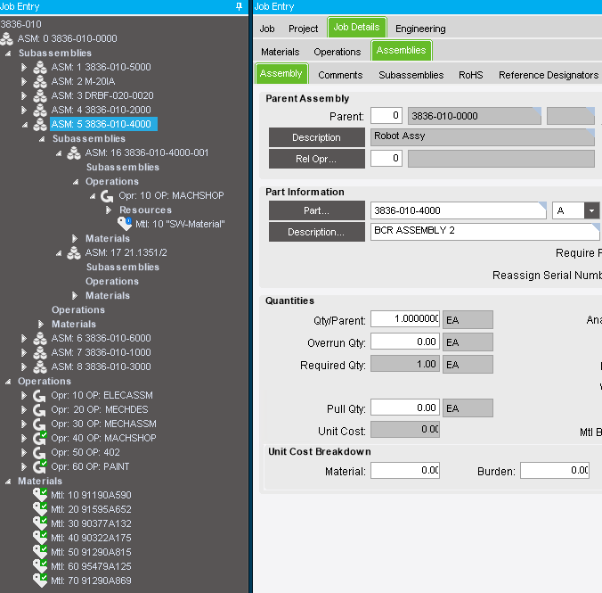

The main assembly on the job has 6 different operations needed to complete it, one of which is machine shop. under that assembly there are 8 subassemblies, some of which may be assigned to that top level machine shop operation. Some of those have subassemblies under them that may require a machine shop operation, which I have nested under them.
Here’s what my structure generally looks like, notice how the first subassembly is not assigned to a specific op(although it will probably end up being MECHASSM), but one of it’s subassemblies has a MACHSHOP op. I would need that part, ASM: 16, to show up in my parts list, with Mtl 10 listed as a material, and a Used On column that shows ASM: 5’s name.
sorry for the long explanation I hope I cleared up what I’m trying to do. here’s the query phrase, I’ll check out that second BAQ and let you know how it works.
