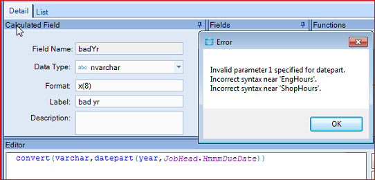

It looks like this is a parser error which has been fixed. I am running a demo of 10.0.700.4 that i installed when it first came out. If I put a bad variable in your year field it gets caught, but if i do it in the second date field it errors out before finding the field.
Greg
I just used the code that you put in there:
Convert(varchar(4), OrderDtl.NeedByDate, 112)
and
Convert(varchar(2), OrderDtl.NeedByDate, 101)
respectively, instead of the datepart without removing anything, and now it works fine. I didn’t know that I could do it that way (sql less than novice here) so thanks for showing me that. I’ll just use that code instead in both places because it’s a lot cleaner way to get the 01 for the months to get them to sort correctly.
