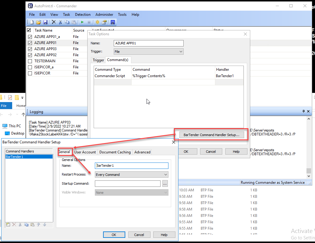

Just got off the phone with tech support and there’s a bug that sometimes happens with Commander where switching printers would cause the drivers to crash. The workaround is to set the handler setup to restart the process after each command instead of every hour (which is default).
This is, of course, fixed in 2016+ since they ditched Commander for IB.
