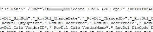

When you look at the generated bartender file you will see that the PRN field is populated.

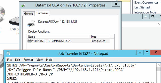

I have the shared printer set up. I can print from the client, server, etc to the shared printer with any document other than my bartender label. When I print my bartender label, I checked the file that contains the printer which displays the correct IP and Name of the label printer. Not sure what I am missing here.

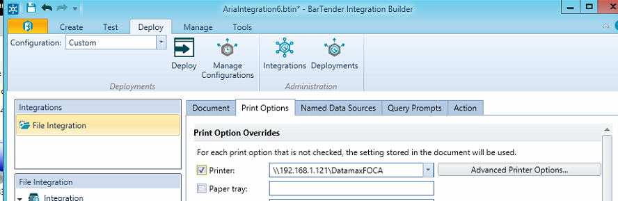

NO PRINT:
If I set the printer in the integration to this shared printer, I can print all day to the correct label printer, but you lose the ability to print to other printers.

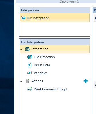

We are using a print command script for our Integration. I am assuming you are using one of the other integration types, as I don’t have a view like you have in your picture. (with the print options part)
Here’s my screenshot:
and here’s a sample integration file (Bartender 2019)
PrintCommandScriptIntegration_sample.zip (1.1 KB)
Unzip and change the Integration/User Credentials and the File Detection/Folder to Scan. The printer needs to be installed on your bartender server (and shared), and using the bartender drivers.
Hope that helps.

It picked it up… now I have to learn about what the failures mean and how I need to structure my file headings.
