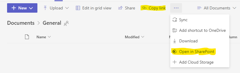

Personally, I would create a Team for each rep and invite them to it. Add a channel called “Sales.” Each channel in Teams gets a Document Library by default. You can get the URL for the Library to use for the MS Graph calls above from the Copy link item.

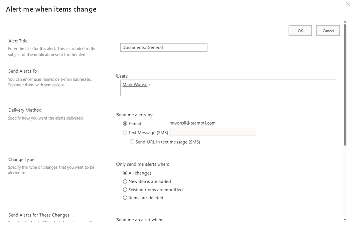

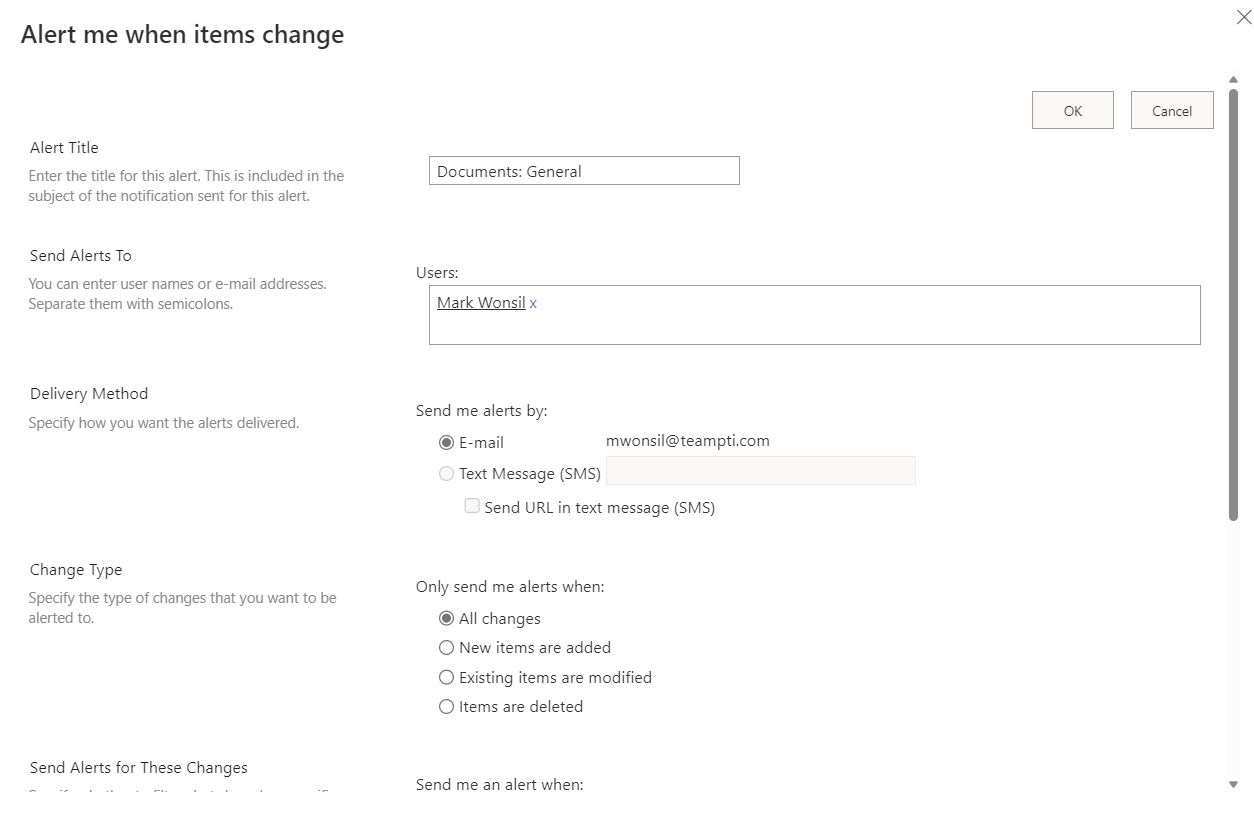

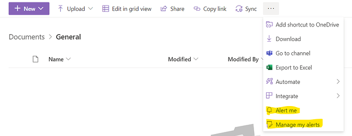

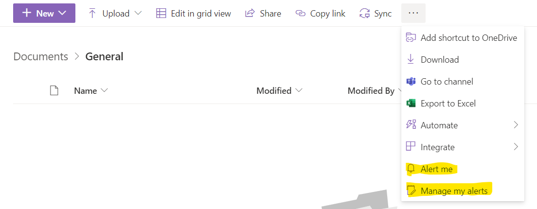

The rep can choose the “Open In SharePoint” link and asked to be notified (Alert Me) when changes occur in the Document Library.
and indicate what, when, and how to be alerted.
