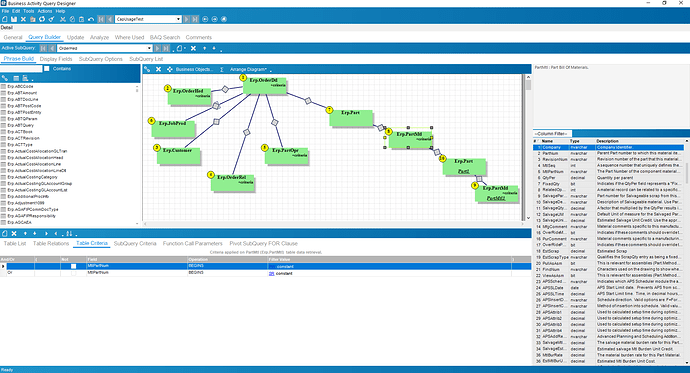

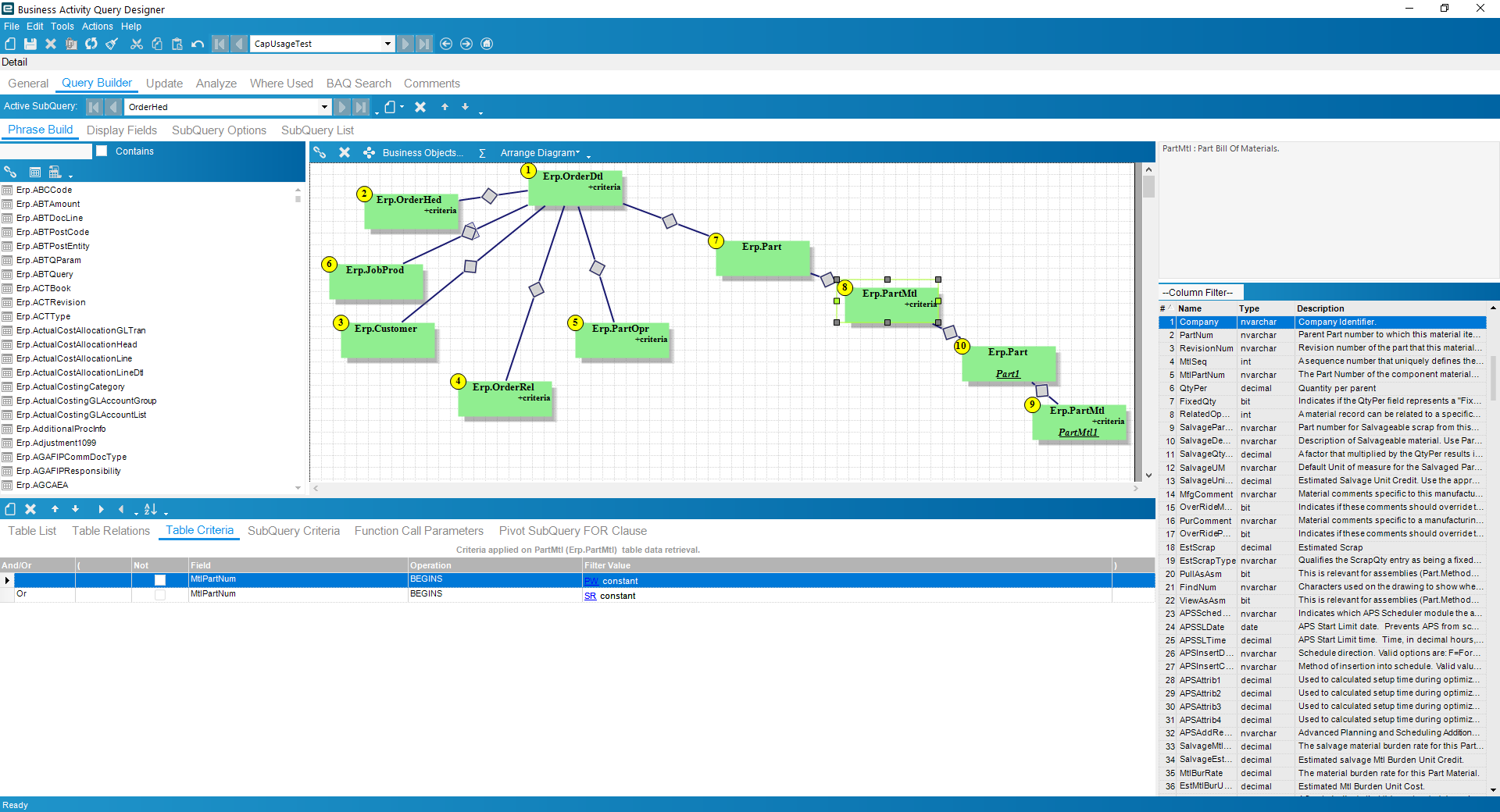

This is how it looks at the moment. I am putting a filter in the first partmtl to look at mtlpartnum that begin with PW or SR, then the second partmtl is looking at mtlpartnum that begin with SR. The SR values are either in the first level or second level depending on if the ordered part has a PW number or not. I am able to get both the PW values and the SR that correspond to it, but the SR values in the first level disappear
If I do not tell the 2nd partmtl to look for SR values the first partmtl finds all PW and SR values as it should
Yash, based on the way you have this query structured here is what it would return:
All order detail lines that have a part material in their BOM that starts with PW or SR AND ALSO have a part material inside of those PW or SR parts that starts with SR.
That is exactly what I need it to do. Expect, when the SR value shows up in the part material from the order detail, it should stop and not look for anything else. It seems as if it only finds the SR parts for the PW parts but doesn’t keep the first level SR parts
Yeah because the first level SR parts don’t have a material inside them that starts with SR, right? BUT the first level PW parts DO have a part inside their method that starts with SR, correct?
Correct
Yash, make the second two tables underneath the first part mtl table LEFT OUTER JOINS. This is the equivalent of saying, these tables/conditions don’t need to exist for my query. In other words, I don’t care if the PW or SR parts have an SR part inside of them, but if they do, show it.
Still not getting all the values from the first level
I did right outer join and it worked!
Thanks for the help! @utaylor
