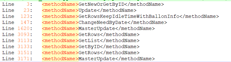

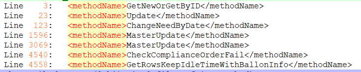

When I run a trace (when the MasterUpdate Directive is enabled), I do see the Method running twice.

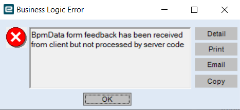

When I run a trace (when the Update Directive is enabled), I still see MasterUpdate running twice, but in this scenario, the update gets stopped by the error message:

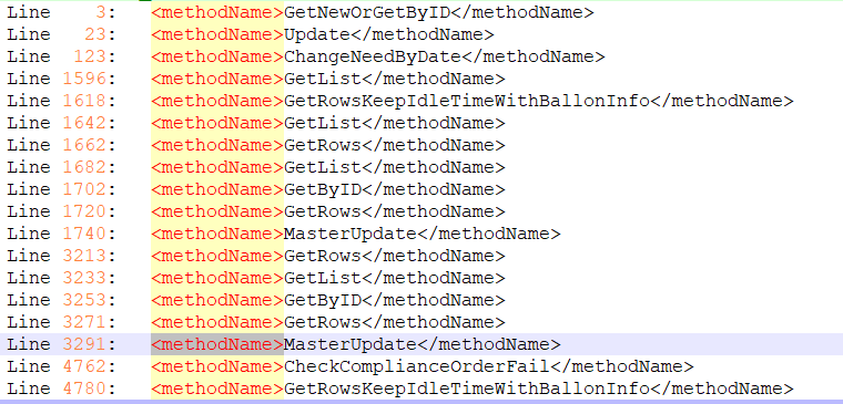

Does Master update run twice with neither BPM enabled? If it doesn’t, then it’s something in your BPM that is causing it to run a second time. I would then try doing the email part on a post-proc.
Master Update runs twice even with neither of these BPMs enabled.

So when you make a change an click save on an OrderHed (and also pushing those changes to the lines and releases), what method is firing? Update or something else?
It’s always best to enable tracing, then do it in the UI to see what fires.
