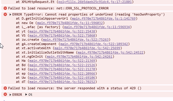

At other times, it takes me through the login process and appears to succeed, but then I just get a white screen, nothing will load. When I look in the console I see

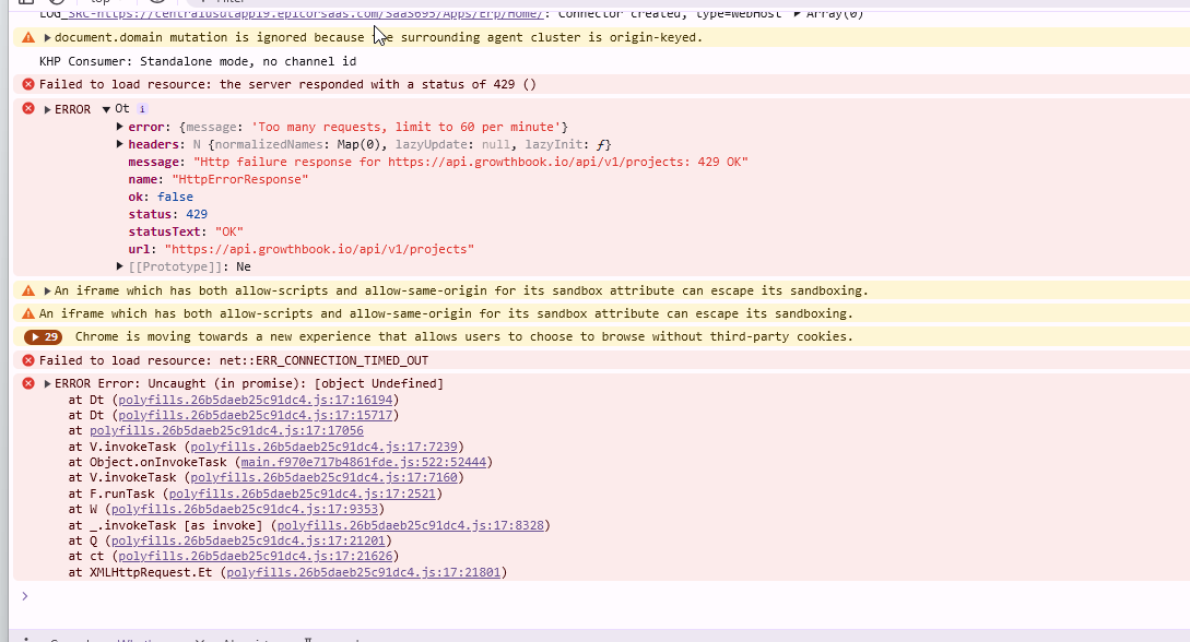

Forgot one, I go through the login process, and then get this:

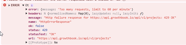

Very interesting. HTTP Response 429 means you getting rate limited. Growth Book is an open source observability tool.
GrowthBook - Open Source Feature Flags and A/B Tests
It collects information using feature flags to see how the product performs under different circumstances. Maybe the tool is blocking normal operation when too much data is dumped to them. :person_shrugging:

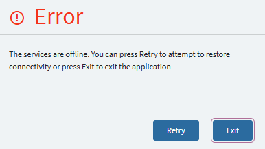

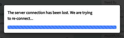

Our users are experiencing connection issue and seeing these.
All they can do is hit F5 to refresh the page to get going again. They lose unsaved data or their place within in the application or module.
Frequency can be as often as every hour. This can happen while the user is actively entering data. It does not appear to be a timeout issue due to inactivity. Based on reports we’ve received, it’s not due to poor network connection. Other applications continue to run fine.

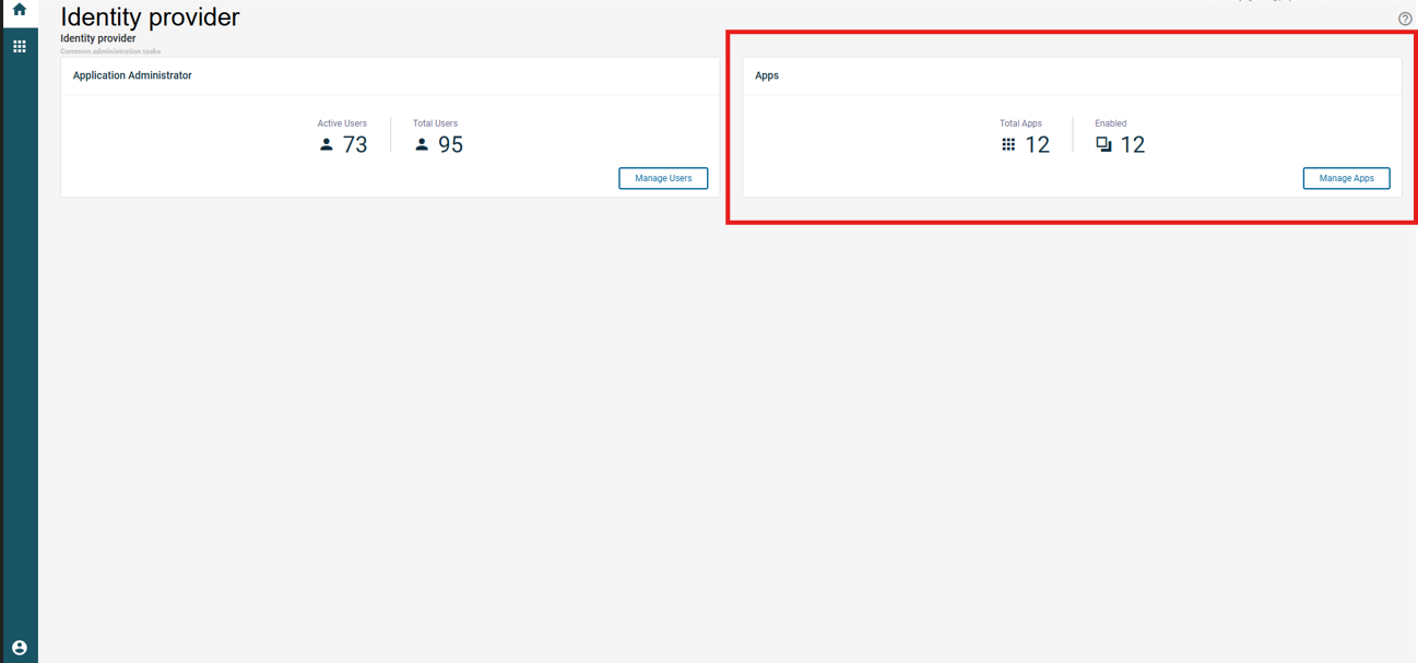

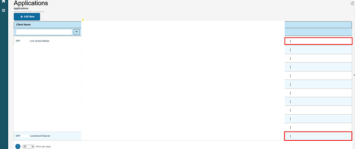

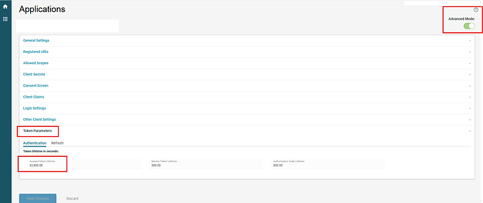

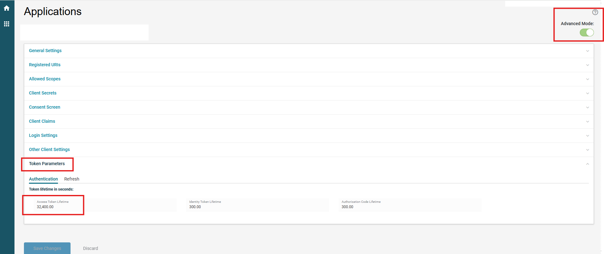

I just made a new case last week, and the support agent suggested we increase the “Access Token Lifetime” for these specific applications to 32,400 (9 Hours) and we haven’t had any of our IDP users randomly timeout or log out since.
