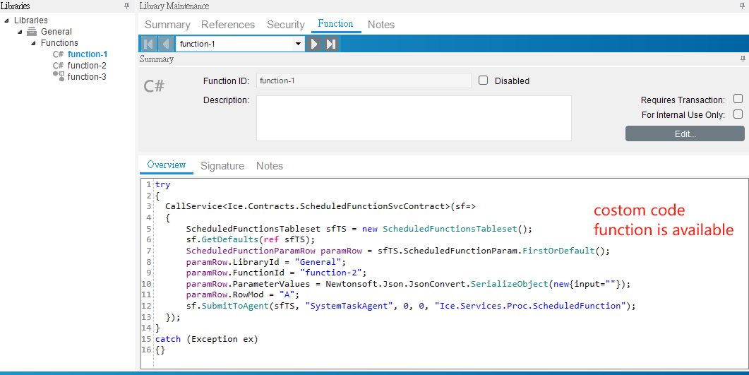

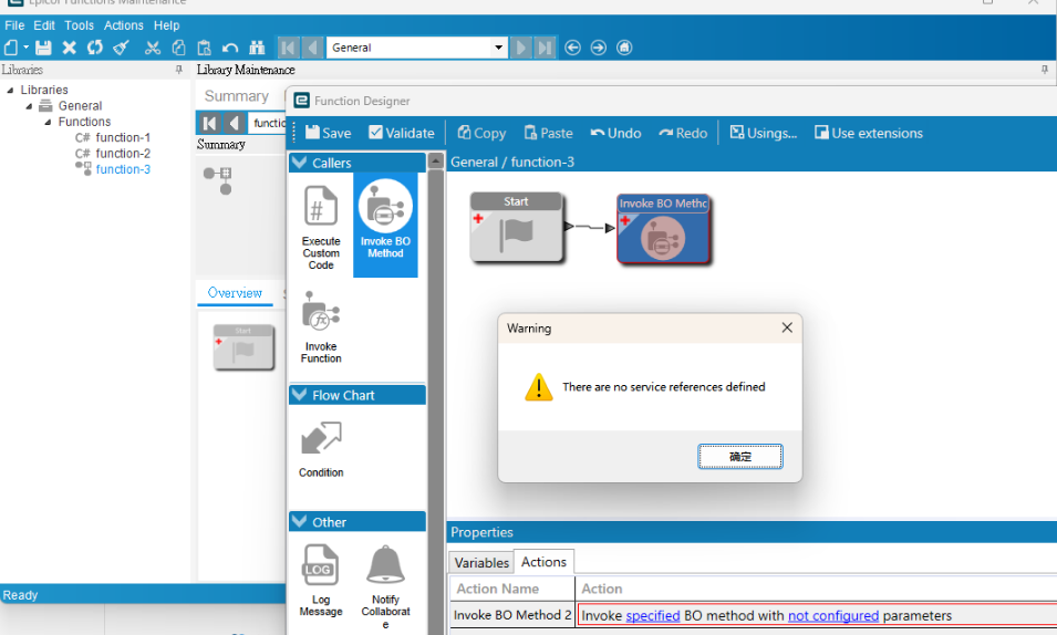

Hello, what am I missing?

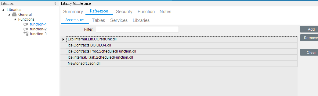

You have to declare you references here.

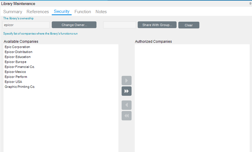

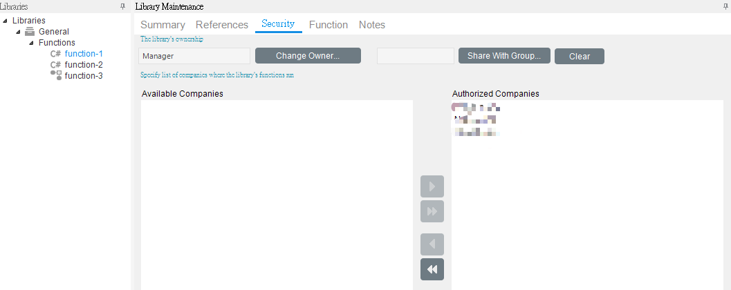

Also, if you are like me, you’ll forget to grant access to the company too…
costom code function is available!

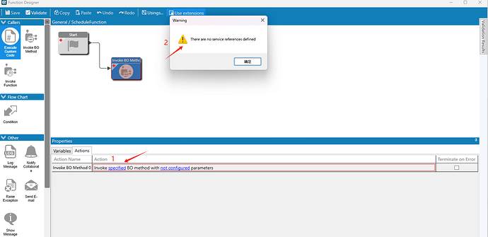

Widget Function with Code still doesn’t work. :thinking:
What does your Services tab show?
Does this need to select a service?
Yes.
