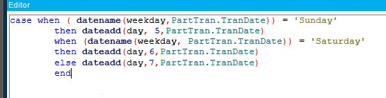

Can "Dateadd" work to add lead time in weekdays only?
It’s a different table date, but this is what I come up with using the functions listed in the BAQ builder. (except for date name, that one isn’t in the list, but still useable)
I don’t think it likes the brackets you have in there.
edit: changed the picture to what actually worked
