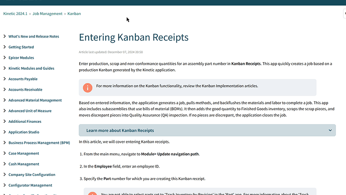

Can I add an Operation without creating a job?
It’s in the help if you search it.
