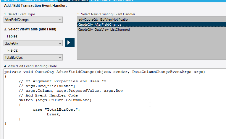

private void QuoteQty_AfterFieldChange(object sender, DataColumnChangeEventArgs args)
// args.Row["FieldName"]
// args.Column, args.ProposedValue, args.Row
// Add Event Handler Code
switch (args.Column.ColumnName)
case "TotalBurCost":
what goes here? Example: ceburden.txt = epicurrencyeditor.value.ToString();
break;
that’s pretty much it. You should have named your new text box, and you make that equal to the field that’s in the data view.
Use the field help to find the name of the field that you are looking for. In this case it’s total burden cost for the one I picked.
Then you use the object explorer to find the properties on that you need to be able to set it.

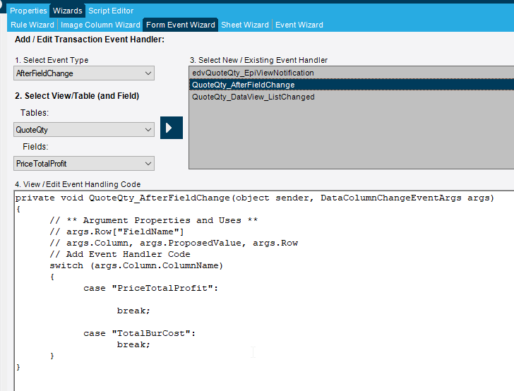

I’m assuming that you want it to update automatically instead of a button? Use the wizard to make an after field change event like shown here. You can add more of your own case statements to capture all of the fields that you want it to watch, then call your method.
Edit: and actually you can probably just key off of on of the total fields, like “PriceTotalProfit” because that one will change when any of them changes.
And it looks like the wizard will add the extra fields for you.
