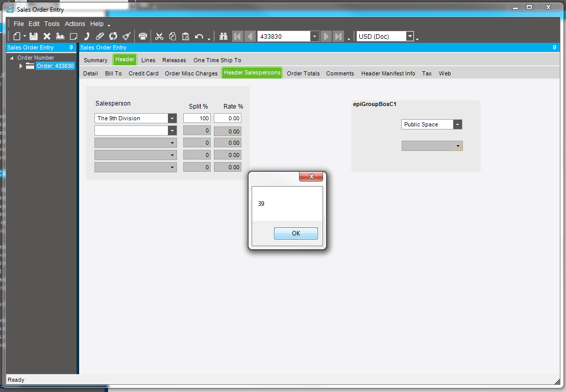

MessageBox.Show(dqa.QueryResults.Tables[“Results”].Rows.Count());
on line 279
i added the line and i get this resoult
Oh wai… I didn’t look at the code carefully…
