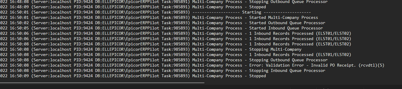

RcvDtl is validating that an RcvHead record exists with the same Company/VendorNum/PurPoint/PackSlip, if it doesn’t you get this error.
Not sure which fields are not matching.

Its short for Purchase Point, so the RcvHead and RcvDtl records must have the same values in Company/VendorNum/PurPoint/PackSlip.
When trying to move the RcvDtl into ELST01 it is trying to find a matching RcvHead and it can’t.
