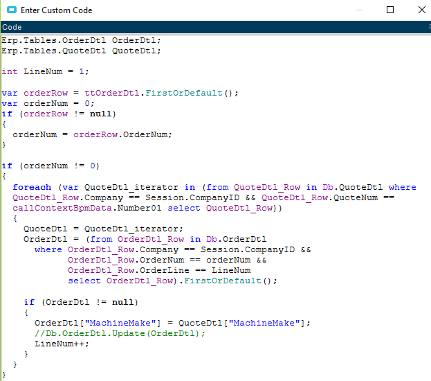

So, my testing is a bust. It won’t actually copy from the UD field from the QuoteDtl to the OrderDtl. I noticed that you have a line commented out. Does the commenting need to be removed so that update line will process?
What’s your actual code look like?
Erp.Tables.OrderDtl OrderDtl;
Erp.Tables.QuoteDtl QuoteDtl;
int LineNum = 1;
var orderRow = ttOrderDtl.FirstOrDefault();
var orderNum = 0;
if (orderRow != null)
orderNum = orderRow.OrderNum;
if (orderNum != 0)
foreach (var QuoteDtl_iterator in (from QuoteDtl_Row in Db.QuoteDtl where QuoteDtl_Row.Company == Session.CompanyID && QuoteDtl_Row.QuoteNum == callContextBpmData.Number01 select QuoteDtl_Row))
QuoteDtl = QuoteDtl_iterator;
OrderDtl = (from OrderDtl_Row in Db.OrderDtl
where OrderDtl_Row.Company == Session.CompanyID &&
OrderDtl_Row.OrderNum == orderNum &&
OrderDtl_Row.OrderLine == LineNum
select OrderDtl_Row).FirstOrDefault();
if (OrderDtl != null)
  OrderDtl["MachineMake"] = QuoteDtl["MachineMake"];
  //Db.OrderDtl.Update(OrderDtl);
  LineNum++;

Remember that my scenario was different; I was building mine off of a method directive that had access to the quote num (it was CreateSalesOrderFromQuote or somthing). Yours is a data directive on QuoteDtl., which is just monitoring when QuoteDtl gets updated. You’ll have to find a way to query the quote in question to return a quote num, but without knowing your specific business problem it’s a little hard to tell you.

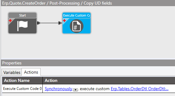

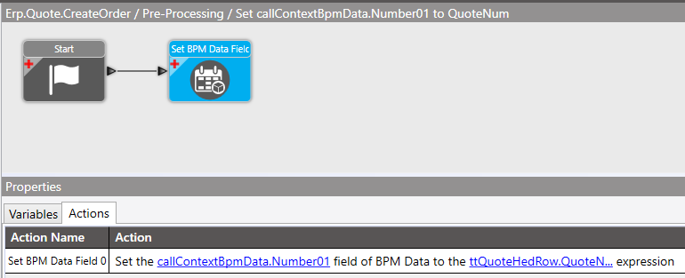

I finally had time to go back and test this out using the Method Directive for Quote.CreateOrder and it works beautifully! Here are some more details for anyone else that may need help getting it working:
Pre-Processing Directive:
Post-Processing Directive:
Post-Processing Directive Code:
int LineNum = 1;
if (orderNum != 0)
//The below 2 lines will help with debugging to make sure it is processing properly
//string body = “1 - An orderNum exists.”;
//this.PublishInfoMessage(body,Ice.Common.BusinessObjectMessageType.Information, Ice.Bpm.InfoMessageDisplayMode.Individual, “Quote”, “CreateOrder”);
//string body2 = “2 - Starting foreach section.”;
//this.PublishInfoMessage(body2,Ice.Common.BusinessObjectMessageType.Information, Ice.Bpm.InfoMessageDisplayMode.Individual, “Quote”, “CreateOrder”);
OrderDtl = (from OrderDtl_Row in Db.OrderDtl where OrderDtl_Row.Company == Session.CompanyID && OrderDtl_Row.OrderNum == orderNum && OrderDtl_Row.OrderLine == LineNum select OrderDtl_Row).FirstOrDefault();
  //string body3 = "3 - OrderDtl is not null.";
  //this.PublishInfoMessage(body3,Ice.Common.BusinessObjectMessageType.Information, Ice.Bpm.InfoMessageDisplayMode.Individual, "Quote", "CreateOrder");
  OrderDtl["FieldName"] = QuoteDtl["FieldName"];
  LineNum++;
