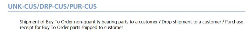

According to the Inventory Technical Reference, it should be UKN-CUS!

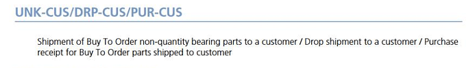

What process can have PUR-CUS type?
According to the Inventory Transaction Hierarchy, PUR-CUS is “Purchase receipt for Buy to Order parts shipped to customer”
