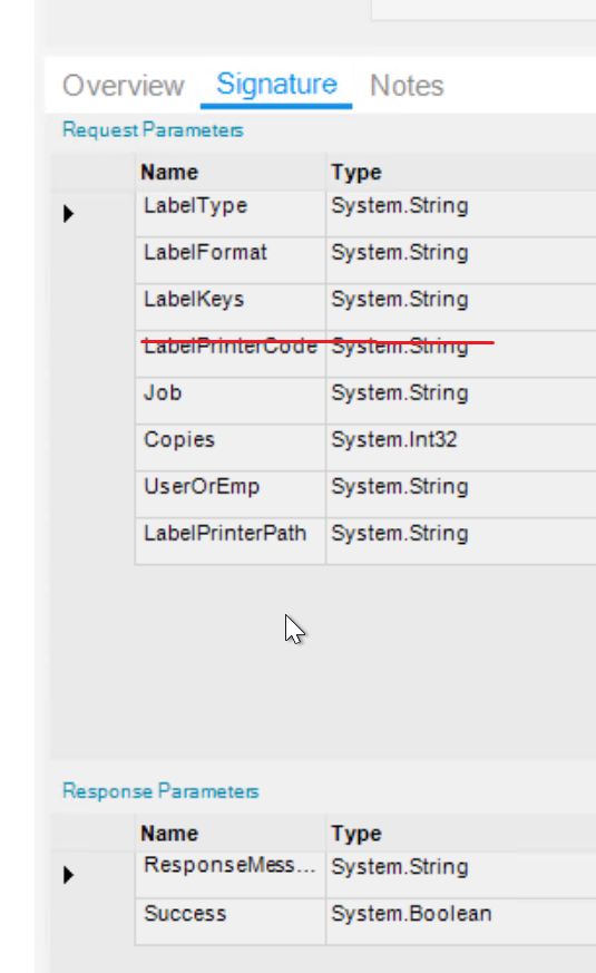

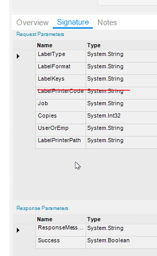

Here is the signature for my generic func to REST call BT.
I have the most common data broken out as individual params. For the key data, I just pass in ~ separated keys that get parsed. There are certainly fancier options here - like pass in a json object.
LabelType determines the BAQ to use, LabelFormat is the BTW template to use.

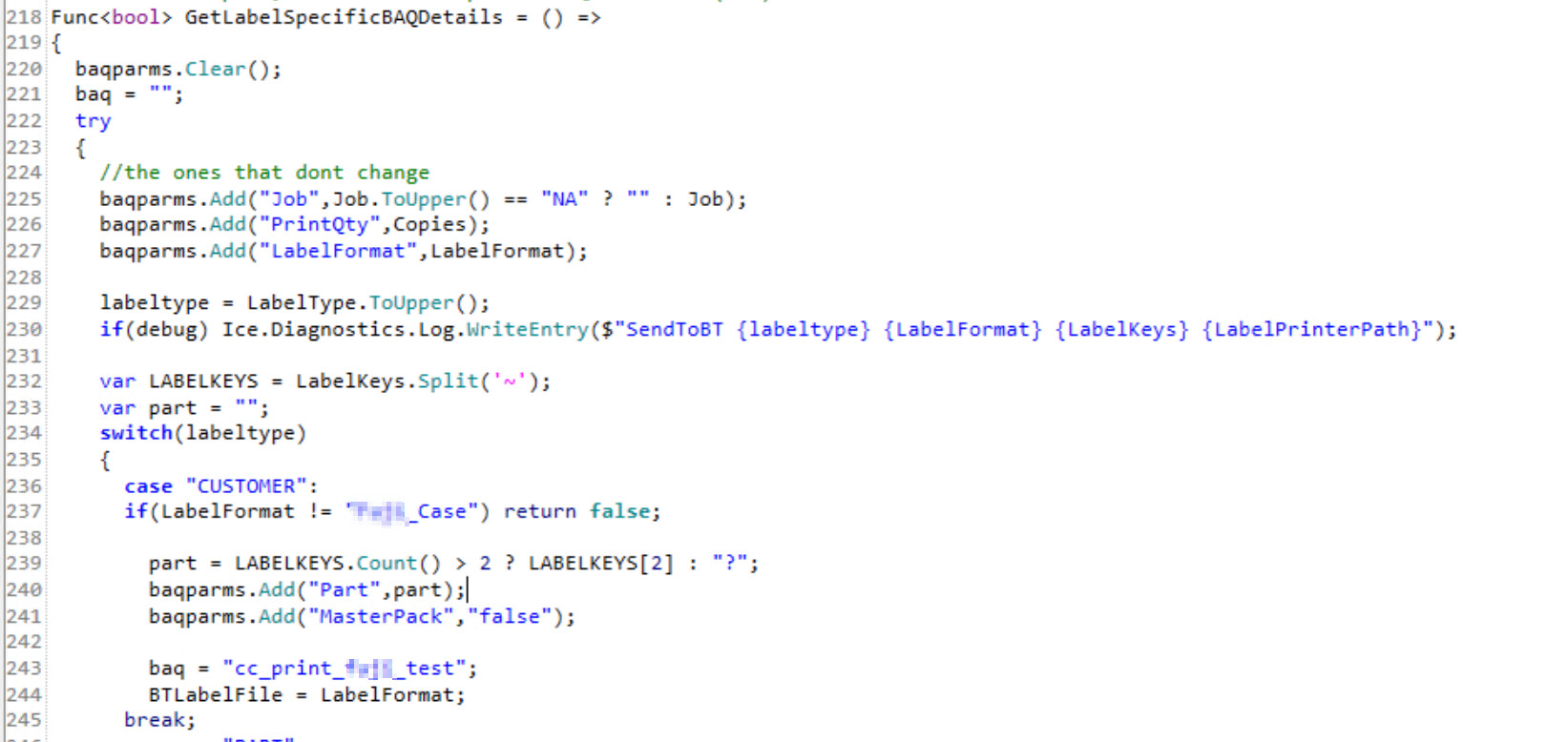

I have some logic that determines what BAQ to call, and which params to use.
Then it calls the BAQ, parses the data, sends to BT
