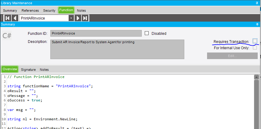

Got it !!
so the “SystemTaskAgent” (from “SystemAgent”) was the fix,
When I got the correlation error after that and finally got to look at the server trace, big long error about transaction enlistment.
Well, when I was fighting the original error at some point I turned on “requires transaction” for the function, so I turned that off and it works !
Thanks for your help, I’ll mark the “SystemTaskAgent” part of the post as the solution
