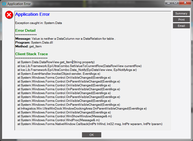

That error is coming up from a combobox … looks like a combo is not setup correctly. Also make sure you have a SysRowID column of type GUID in your data table.

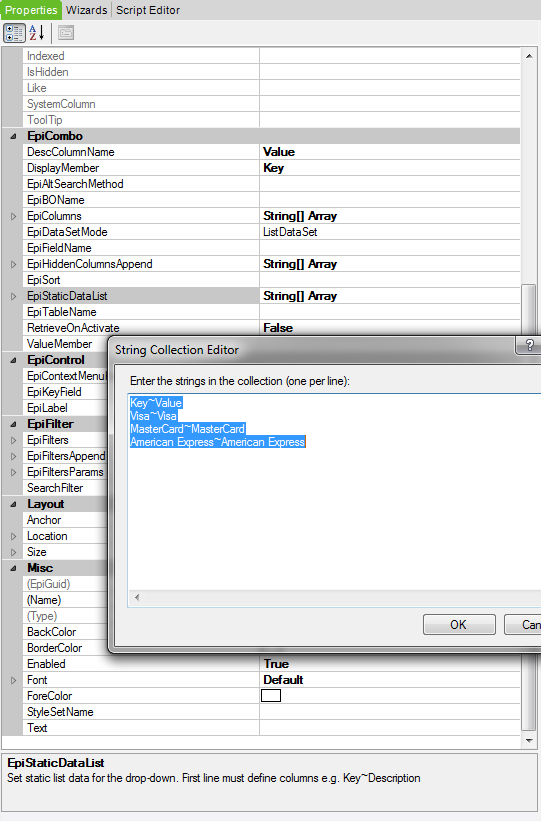

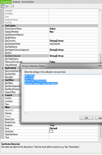

The hard coded combobox “DescColumnName” property apparently needs to match the binding name in the epidataview.
Old:
New:
