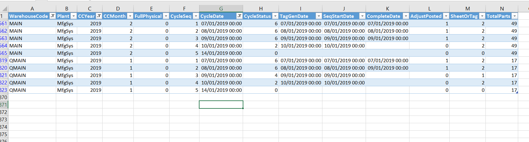

Thanks for your comments…i’ve just exported the table CCHDR and done some filtering, it seems the line were having trouble with Qmain on the 9th Jan has a cycle status of 4…when i took the filters off, this is the only row with a 4…so i’m curious what these all mean.
Follow up…This code will indicate the status of the cycle. When status is zero the cycle is scheduled but not started. Inventory is frozen at sequence start.
Code/Desc:
0 = scheduled
1 = tags generated
2 = Count started
3 = counts entered
4 = recount tags generated 5 = (not used)
6 = completed
7= canceled.
