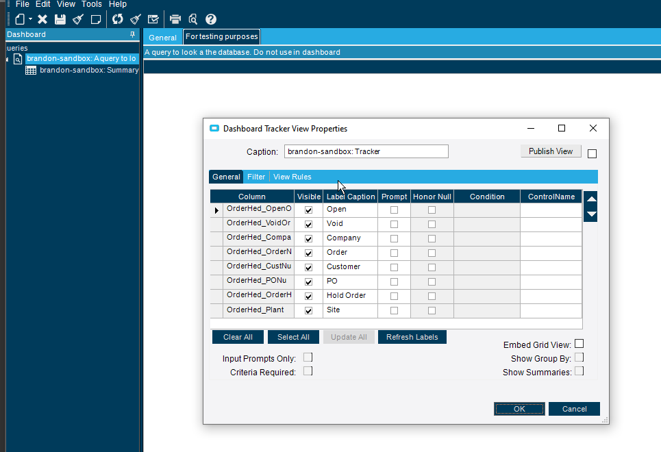

What if we scope it to just this for now:
When you add a Query (BAQ) to a dashboard your tab are: General, Publish, Filter
We are talking about adding an addition tab Parameters
it would look very much like the filter tab - except you cannot add or set columns here you simply see the list of BAQ parameters and you cannot control condition it is just equals.
You can then map that parameter to the same value options you have when setting the filter. If you leave it unmapped you get the prompt to enter the value like you do today.
If we go to size this and do, I want to keep the first pass simple. Every additional complexity layer adds significantly more cost and my goal is to keep this small enough that we might be able to just sneak it in one dark sprint. If it gets too big it goes into the ‘whose demands for the release get done’ scrum and past experience doesn’t bode well.
So if this basic set meets your needs, I’ll go grab a developer and get them to size it up for me.
This needs to be in the add a tracker though. Not in the add BAQ. The tracker needs a field for the user to type in something that will be used as a parameter. So really just adding the parameters from the BAQ into the list on the general tab, would be all that needs to be done.
The way you proposed, the parameter may not be a column value, so the mapping as you explain it would be odd, because only columns in the query show up in the tracker.
Perhaps in that the instance of a BAQ having params it forces a tracker panel even and that does what Patrick described functionally but from the panel. The panel would be editable like normal but the query fields handled like native fields in any screen we can’t touch them. Not sure if that falls into the realm of not flying under the radar though lol
