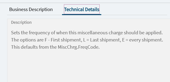

Just to clarify, If I make 2 or more shipments for the same order, and the misc charge has a frequency of “First”, the misc charge will only be applied to the first invoice, not any following invoice?
Here I thought the frequency referred to the lines. I thought the misc charge would be applied to the first line (the alternative being applying it to all lines).
This is very helpful information, thank you for sharing!
That’s correct. I’ve never used the “Every” option, so I am not sure how that one works, but “First” means it will apply to the first shipment of any line on the order (if it’s a Header Misc Charge), or the first shipment of any quantity tied to that line (if it’s a Line Misc Charge). If it’s “Last”, then it applies to the final shipment that closes out that order.
