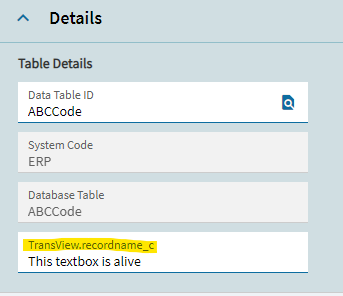

Further assumption is that your textbox was greyed out because the EpBinding you were using didn’t exist in the ZDataTable DataView, which is why I assumed you would need to add it there.
You could always set the EpBinding of your field to TransView.recordname_c.
You then would need an event with a row-update to take the value of TransView.recordname_c and pass it to ZDataTable.recordname_c (its final resting place).
