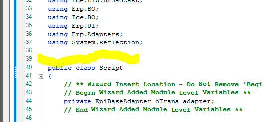

The main feature is that you can declare classes of your own before the Script part of the customisation code.
You need some extra “usings” and the DynamicQuery assemblies:
using Ice.Core;
using Infragistics.Win.UltraWinToolbars; // for manual button addition
using Infragistics.Win.UltraWinGrid;
using System.Collections;
using System.Collections.Generic;
using System.Linq;
Then the class is:

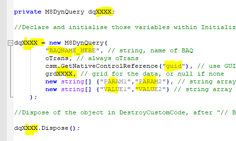

To use it, you declare one variable per BAQ needed, at the Script level (after “// Add Custom Module Level Variables Here **”):
private M8DynQuery dqXXXX;
Declare and initialise those variables within InitializeCustomCode:
dqXXXX = new M8DynQuery(
"BAQNAME_HERE", // string, name of BAQ
oTrans, // always oTrans
csm.GetNativeControlReference("guid"), // use GUID of the panel where the controls are
grdXXXX, // grid for the data, or null if none
new string[] {"PARAM1","PARAM2"}, // string array of BAQ parameter names, or null if none
new string[] {"VALUE1","VALUE2"} // string array of initial parameter values, or null if no parameters
Dispose of the object in DestroyCustomCode, after “// Begin Custom Code Disposal”:
dqXXXX.Dispose();
