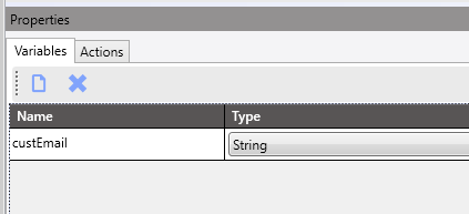

  1. Create a variable in the BPM
  2. Add a Set Argument/Variable widget
  3. Select the variable you created in step 1, and for the expression, enter the code above

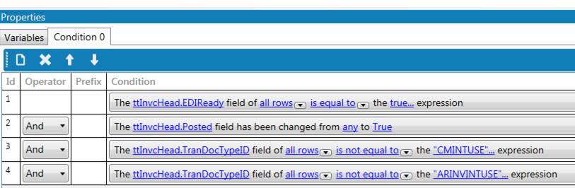

  4. Add a Condition widget to check the value of the variable. If it is not equal to ""
