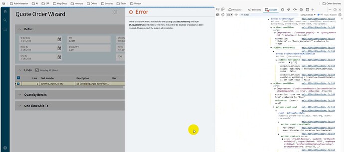

I did capture the error, what does this means Randy?
Randy
(Randy Stulce)
25
There are threads on here about that error. It means there is no menu item with that combo of app (SalesOrderEntry) and Layer.
salderete
(Sam - Lok'tar ogar!)
26
Hi Randy it works. I have it all wrong coz the layer Iām calling was not really exist on Order Entry lol my bad
Thank you again!!
