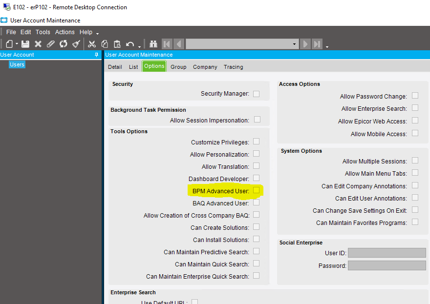

I get this error when trying to import…
Description: The package selected for import uses restricted BPM functionality. Importing of this package is only allowed to users with BPM Advanced privileges.
Ah… I’m a MT Cloud user. I don’t have that

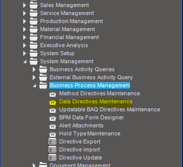

Go to System Management > Business Process Management > Data Directives Maintenance
Click New Standard Directive > Select table POApvMsg
Enter Directive Name, Group and define Scope.

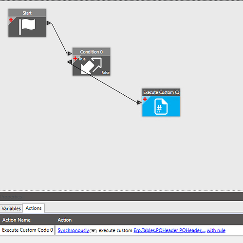

Click Design and Insert Workflow component Condition and Execute Custom Code.
Select Condition and add below lines
Select Custom Code and Click code
Paste below code
po approval.txt (4.0 KB) -
Link Component Start > Condition (True) > Custom Code

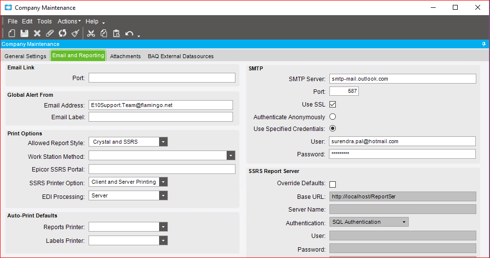

Note : - make sure your smtp server details correctly entered and working
Very kind of you to add screenshots like this. Easy to follow. Thank you, Surendrapal.
