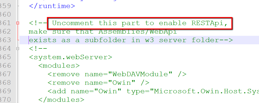

Perhaps in Epicor Case its to remove the Handlers for it to avoid Auth for the preflights – inspect you web.config vs web.config.template and if you are using SSO WebDAV you might need to enable more things…
Examples of what it should look like:
Perhaps once again your using an older web.config or need to do

As a matter of fact our ERP Admin Upgraded our Test Environment, while he Rebuild our DEV Environment look at the difference both 10.2.300.13
Test since its an older web.config exhibits all kinds of API Issues. Token, fix that, then its something else etc…
While DEV Works fine.
