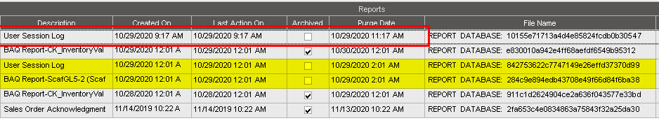

In 10.2.300, a report with no archive setting, isn’t deleted right away. There is a column in the System Monitor named “Purge Date” that appears to be set to 2 hrs after the “Last Action On” (row outlined in red, in opict below)
And it’s not uncommon for me to see rows in the Report tab, that persist beyond the Purge Date. The highlighted reports should have been purged yesterday, but are still shown. Plus, selecting one and choosing Print Preview, does cause the report to be previewed again.
