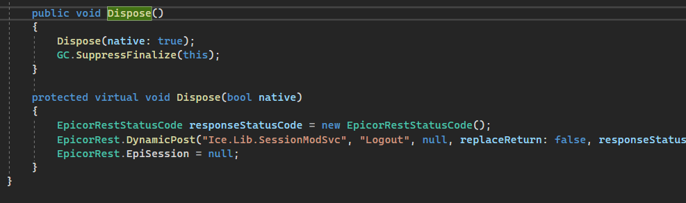

@josecgomez … Hey … I’m getting this JSON error when the session is getting disposed.
 at Newtonsoft.Json.JsonTextReader.ParseValue()
   at Newtonsoft.Json.JsonTextReader.Read()
   at Newtonsoft.Json.JsonReader.ReadForType(JsonContract contract, Boolean hasConverter)
   at Newtonsoft.Json.Serialization.JsonSerializerInternalReader.Deserialize(JsonReader reader, Type objectType, Boolean checkAdditionalContent)
   at Newtonsoft.Json.JsonSerializer.DeserializeInternal(JsonReader reader, Type objectType)
   at Newtonsoft.Json.JsonConvert.DeserializeObject(String value, Type type, JsonSerializerSettings settings)
   at EpicorRestAPI.EpicorRest.DynamicPost(String bo, String method, Object postData, Boolean replaceReturn, EpicorRestStatusCode responseStatusCode, CallContextHeader callContextHeader)
   at EpicorRestAPI.EpicorSession.Dispose(Boolean native)
   at EpicorRestAPI.EpicorSession.Dispose()
… it’s happening in EpicorRest, showing [decompiled]:
Newtonsoft version is 11.02 but haven’t made any code changes to the project.
Any ideas?
UPDATE: It doesn’t seem to occur reliably. Can anyone surmise why/what circumstance this might happen?
