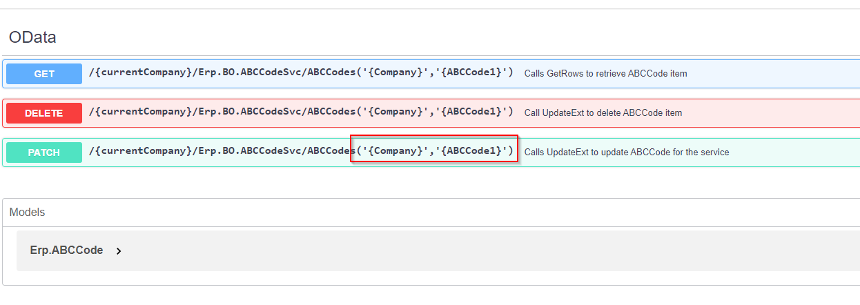

Epicor/Kinetic is not totally REST-compliant at this point. I use the Swagger/Open-API page to see which requests are valid.
When you are patching I believe your endpoint needs to have the Primary Key
Notice the Patch call has the Company and ABCCode in the URL as params.
So you need to do
var response = EpicorRest.BoPatch("Erp.BO.ABCCodeSvc", "ABCCodes('MyCompany','A')", patchData, callContext);

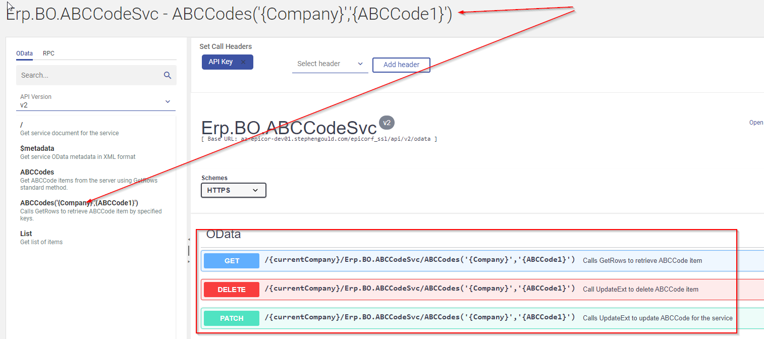

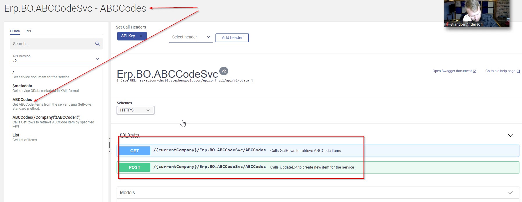

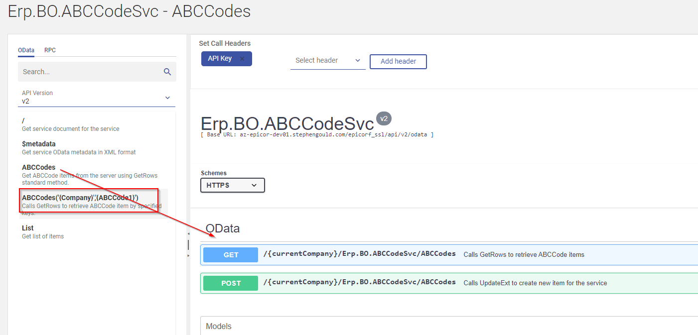

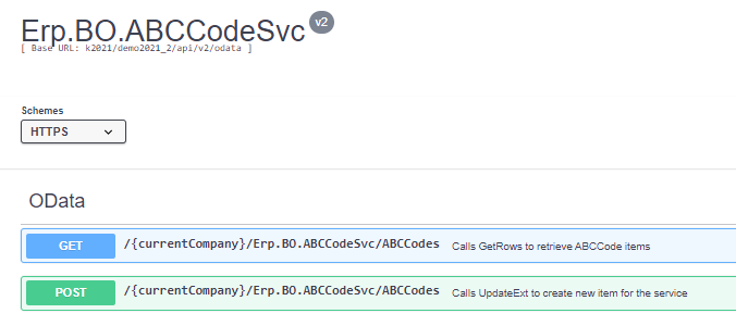

Why does your Swagger Page have Delete and Patch and mine does not?
Because the new helper page is a bit annoying by default it shows you the method available to the “FIRST” endpoint but if you click on the second endpoint ABCCodes()… (Square in my picture) then you’ll get additional options available for that EndPoint
