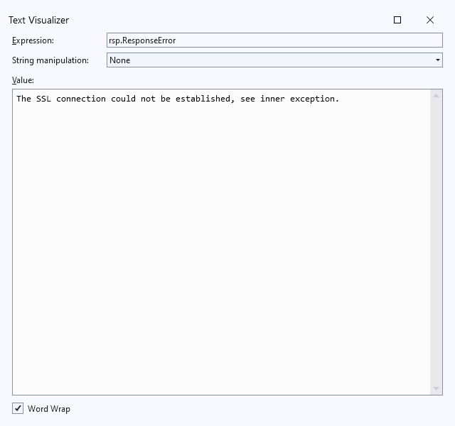

Jose, tried my REST call after making adjustments, however I’m getting the below error:
I’m attaching my settings file:

I’m using the APIKeyPilot value in the program at the moment, and verified it’s correct. How can I get around the SSL issue? I have the certificate for the AppPoolHost installed on my system.
are you reading it from that settings file if so you are doubling up on your https it should be just
server.tld.com // not https://server.tld.com if you are reading this value in for the EpicorRest.Host
Value I’m using for the AppPoolHost property is just the FQDN of the server, no HTTPS:// on it. The AppPoolInstance value should be the app pool name, right? not like “net.tcp:///”, correct?
Correct
Then this doesn’t make any sense… I’m doind exactly what you’ve suggested and still getting the error. I’ even have the IgnoreCertErrors property = true.
can you access the calls through POSTMan?
Do I need to do the CreateBearerToken() call before a Post function call?
You don’t need to do CreateBearer at all unless you need a bearer token. That was just an example.
Can you successfully make the call using Postman from that same machine?
Yes… That’s what is so crazy about this, Postman works calling the function
You are setting something incorrectly in your code I can’t see that from here without running your code for you i’m not sure how to help you.
I gave you working code that runs in that github project. Does that work for you? if you change the settings?
I’ve been trying the RestExample project over the past few minutes with my parameters and trying to run the zCustomers01 BAQ, then one of my own. I’m getting back a 404 error in the ResponseBody:

Sorry, I misstated the original BAQ in the project, it’s zCustomer01…
Jose, could any of these issues I’m having be related to the Epicor version I’m on? We’re still on 10.2.700.21. Also, I haven’t tried PostMan recently, I’ve been using the V2 Help pages to run the function.
No this is not related to your version of Epicor. I thought you said you tried postman, see if you can get postman working.
Jose, I apologize for taking so long to get back to you, I was on vacation Friday thru Monday. I got Postman working with the help of a colleague, but I’m still getting a 401 error when attempting the POST call:
