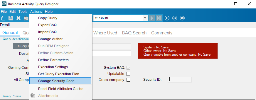

Not only is going through the system BAQs a labor intensive process, but selecting each BAQ’s security to ensure that it won’t mess up any of my users seems tricky at best.

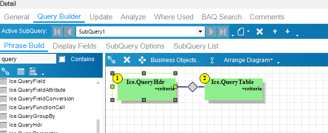

  • Add Ice.QueryTable to the BAQ above.
  • Create a Calculated field that assigns the value from above.
  • Add a SubQuery and include the above subquery
  • Take the MAX of that value and use that in your Excel to assign a SECCode for the UDASH.
That should cut down on the effort of going into each query to identify sensitive information and assigning the SECCode.

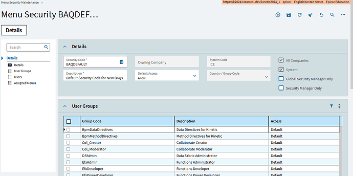

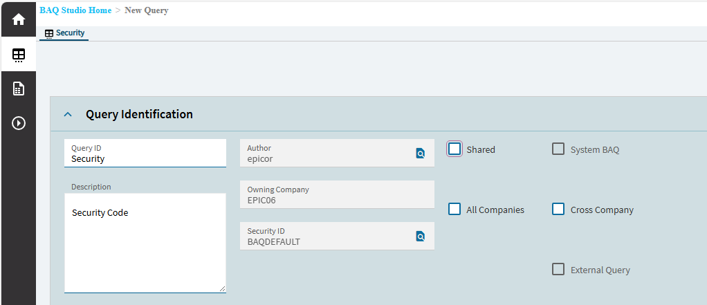

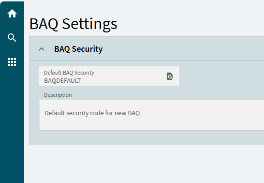

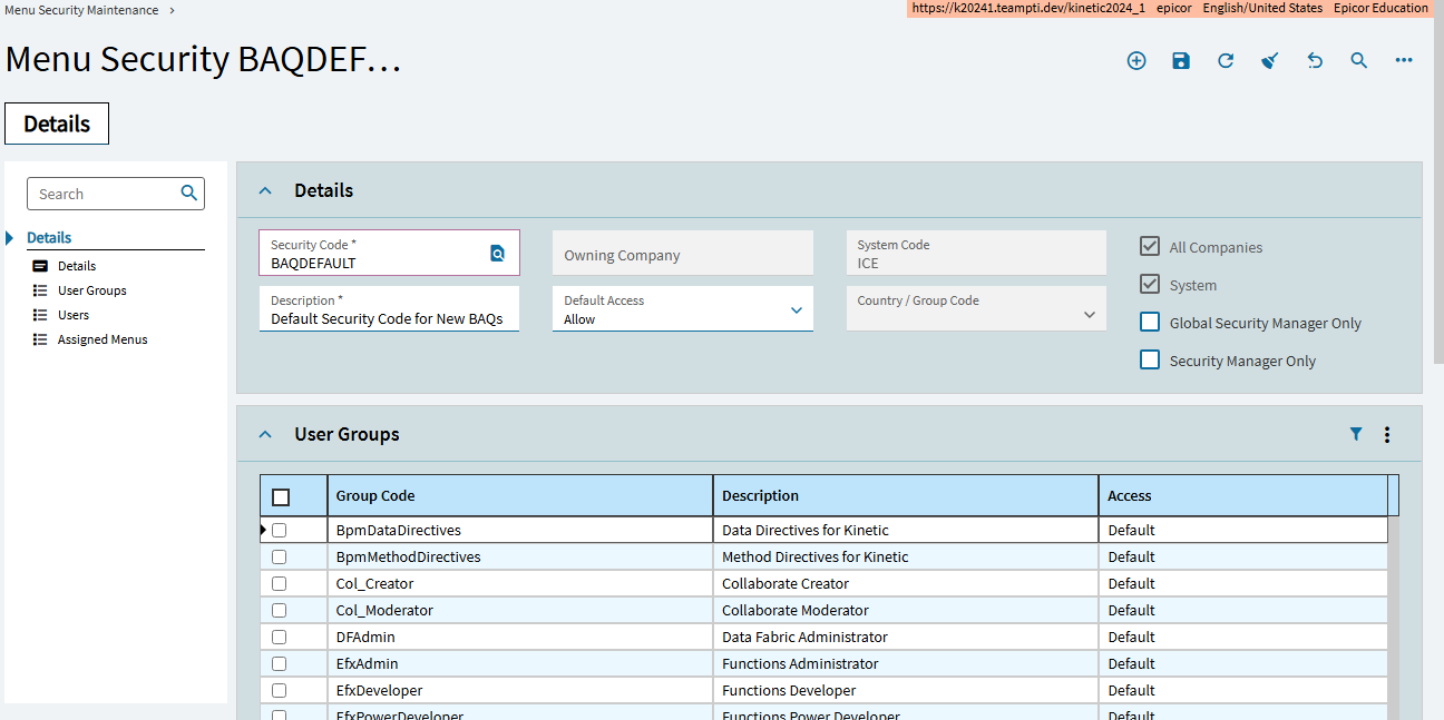

Better late than never? For those of you who remember this thread and are on 2024.1 - might be earlier - @Olga when did this go in. Anyway go to menu in the browser UI and search for BAQ Security. Open that form.
Olga may have mention this somewhere else. Just in case I thought I’d mention it on this thread…
2024.1. new UI, new default BAQ security code.
