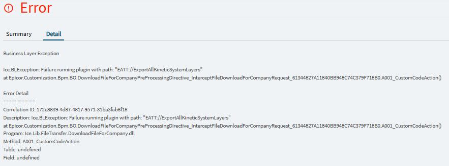

Hello Kevin,
When trying to run the previous in the cloud, I get the following error:
I’m reasonably confident this is a SaaS cloud issue as a user without an SDK license.
In case it’s not, I’m sharing for posterity.
