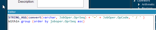

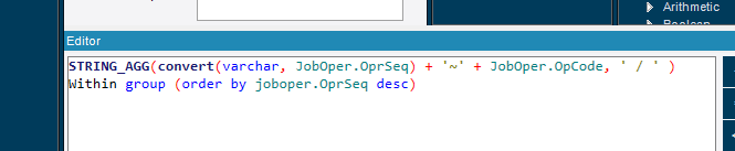

I got it. Looks like you need “Within Group” added in there. Here is an example with job operations ascending and descending. Let me know if you can’t get this working.

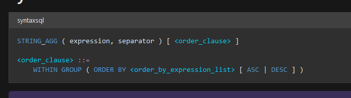

Here’s where it is on the page in the docs.
And this is what you need for the partOpr table. I’m not sure what you were trying to do with the cast in there, but you don’t need it for this to work. The OpCode is already a string, so nothing to covert there.
String_Agg(convert(varchar, PartOpr.OprSeq) +'~' + PartOpr.OpCode,' /') Within group (order by PartOpr.OprSeq asc)

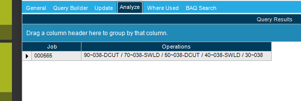

what seems odd is that the “STRING_Agg” command runs fast yet seems to ignore the tables index order when displaying data.
Could adding the “Within group (order by joboper.OprSeq desc)” be blocked since I’m on epicor public cloud?
I’m not sure. I know this doesn’t help, but “It works for me”… It will probably take more research to figure out what the issue it. The SQL version will probably come into play here. I wish I had a more definitive answer.
