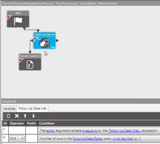

I ended up just creating the functionality via the User Process Scheduler and a BPM with custom code.
Yet another great use case for the User Process Scheduler! (I promise I don’t make commission on each time I rep it )
Created the BPM and gave it a condition. I could not figure out how to do this natively with widgets, but I’m sure it could probably be done with enough knowledge.
Code:
